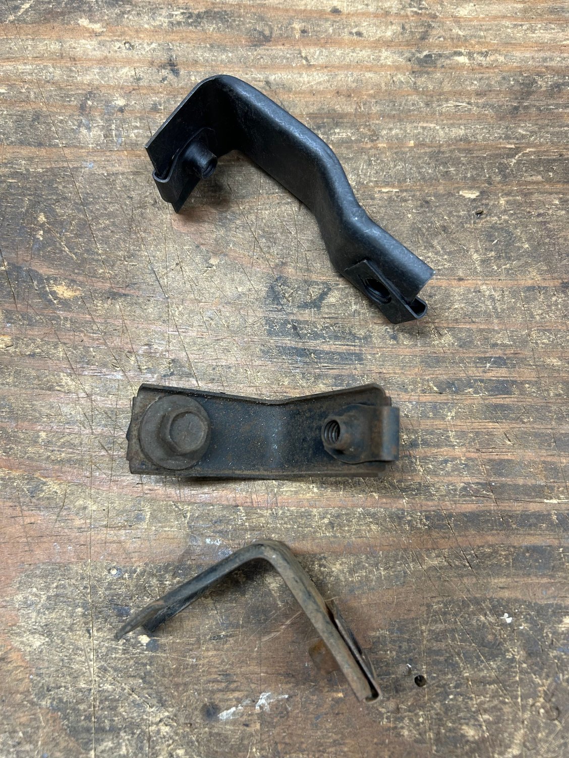

I am doing a ground up restoration of my 79 F150 am at a loss as to where some brackets go on my truck.
Its been 2 years since I disassembled the truck and I hate having leftover parts lol. Any help would be appreciated.
You guys have been the best help I have found so far on my issues and I hope I can help someone else out in the future.
The bottom 2 are the same bracket.

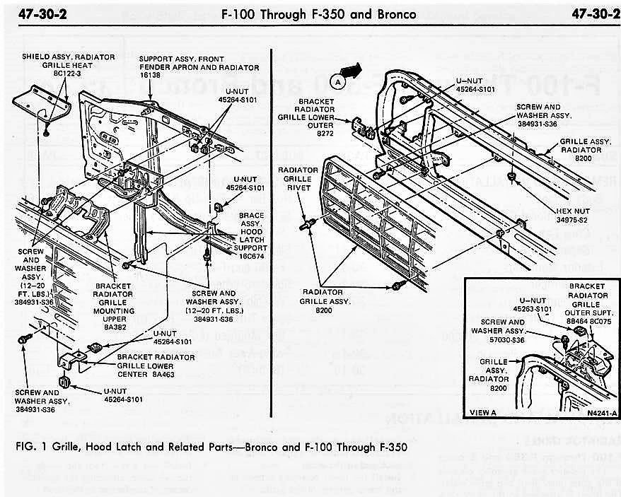

I bet they are for the grill shell area or maybe the insert for the grill shell. Maybe hold offs for the grill shell from the core support. The one in the top pic looks like the (Bracket Radiator Grill Lower Center 8A463).
Other 2 are maybe on the sides, Bracket Radiator Grille Lower Outer 8272

Almost / kind of .... look like something used with an AC condenser in front of a radiator.

I guessed up front somewhere. You are correct!
