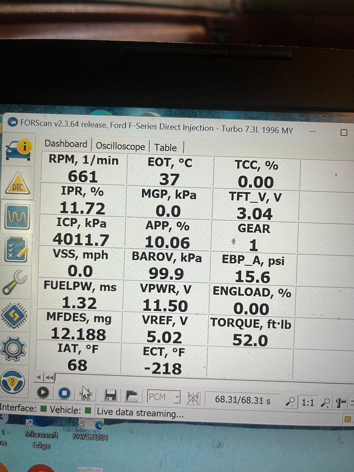

Is there a way to save or record the live stream data that is showing up my screen? I’d like to take it for a drive to see what is happening when it dies and not have to be watching the computer.

This is the picture of the dashboard of when it started. ICP is 581 psi I’ll figure out how to get the proper units displayed eventually

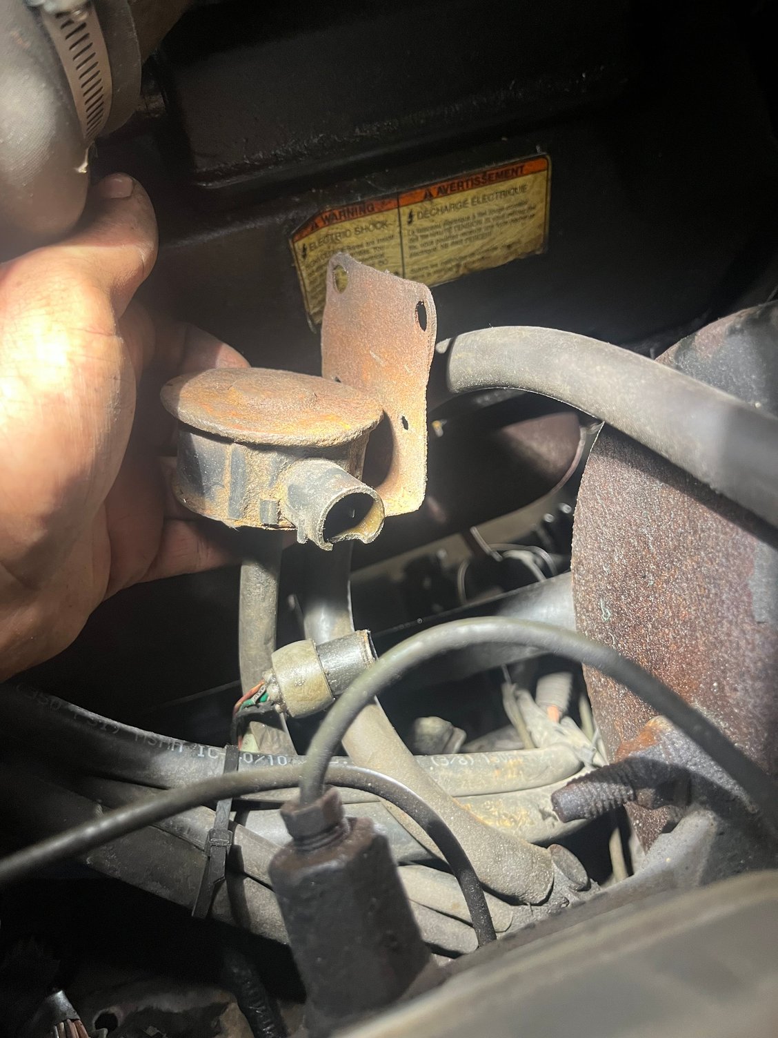

Found this tucked away under the brake booster. What is it and why does it smoke when I plug it back in?

I dont recognize that part.
Where is the hose connected to and where does it smoke?
I believe that is a vacuum sensor for the brake light in the dash. It is supposed to turn the light on when it senses low vacuum. I would say the sensor is bad if it smokes when plugged in.
