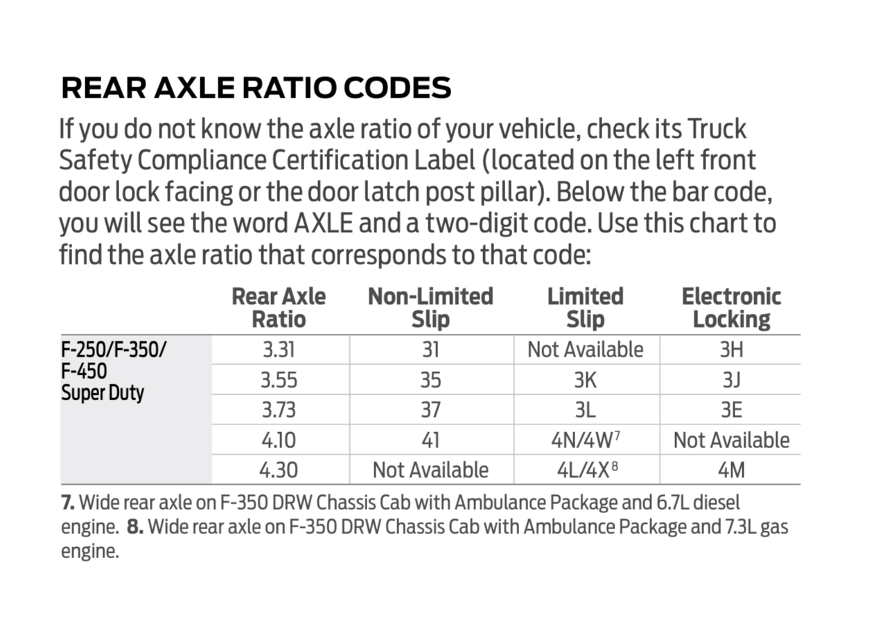

Does anyone have a chart that shows axle codes and gear ratios? Seen it before but cannot find it.

Source:
https://www.ford.com/cmslibs/content/dam/brand_ford/en_us/brand/cpo/pdf/2023_Ford_Super_Duty_Pickup_Towing_Info_Dec16.pdf
