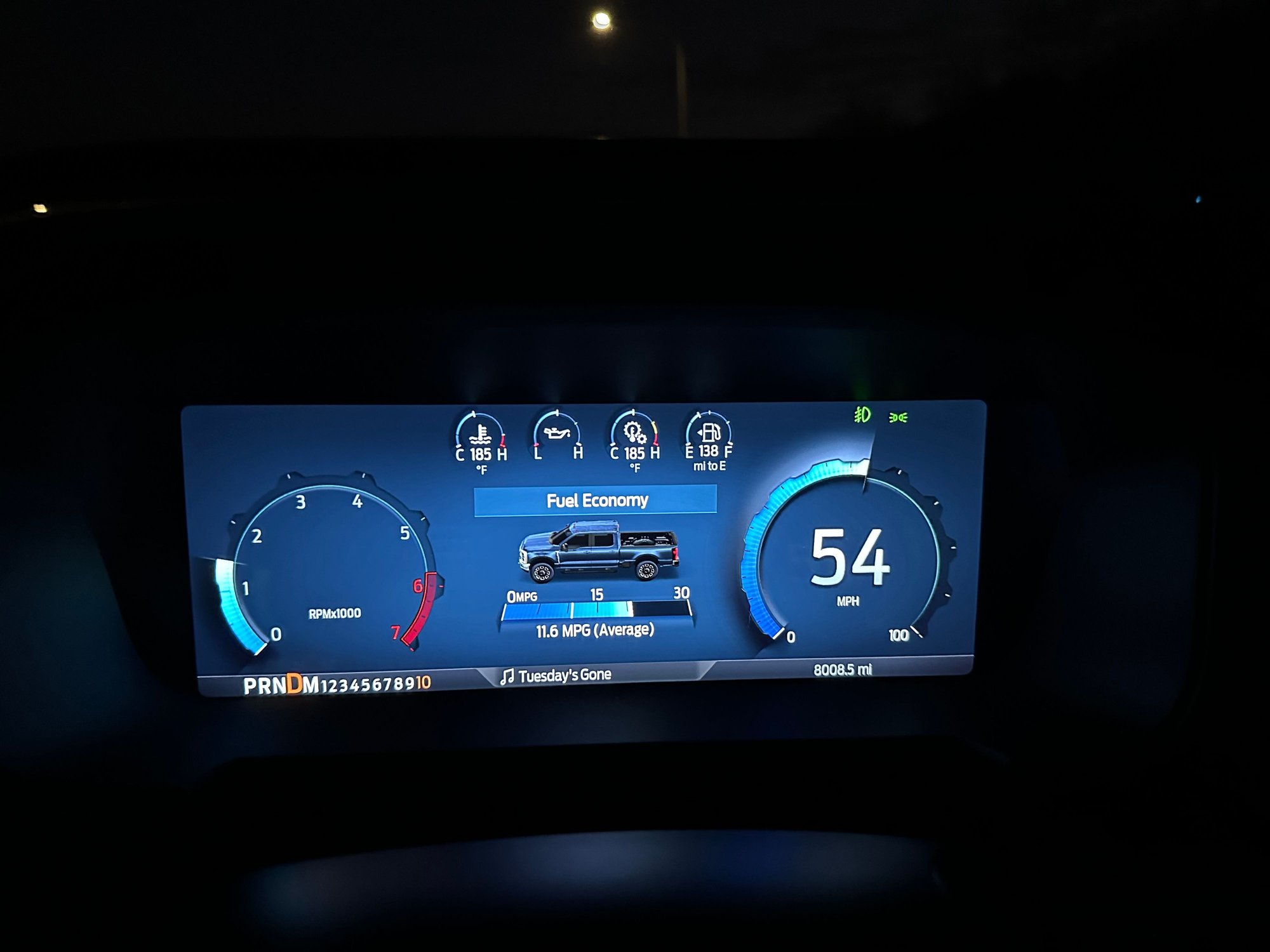

No clue how it failed but the symptoms were a non functioning GPS and then no access in the Fordpass App. Just over 8k miles on the truck as I snapped this picture of the mileage last week.

Lol. Never gets old!
