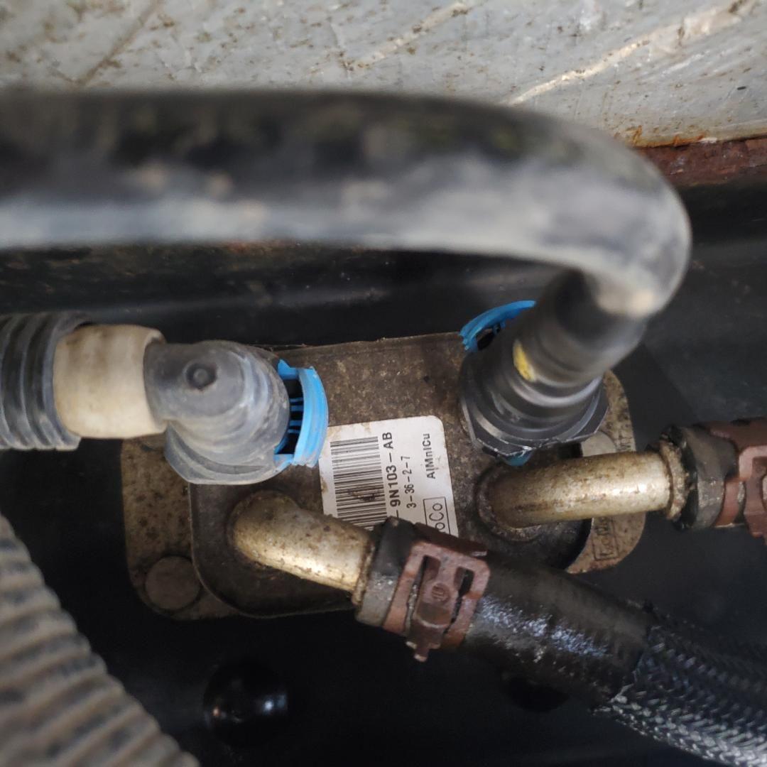

I smelled fuel every time I would get out of the truck and discovered this leak underneath on the driver’s side, does anyone know if this connector can be changed or do I need to replace the whole line? You can see a drip coming from the one on the right on the cooler. 2013 Super Duty 6.7

Don't know if this could be an option to "build not buy" a fix for you, but check it out...
https://www.accuratediesel.com/2017-...epair-kit.html
Not sure if it's the same size locking quick connect but im thinking it should be.
From this page here, is this here which I think is the line set that connects to the fuel cooler it seems...
Not cheap, but just throwing it out there... I'll see if I can find those locking style quick connects also... in a straight fitting.
