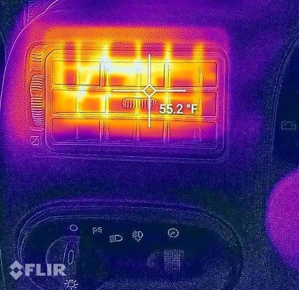

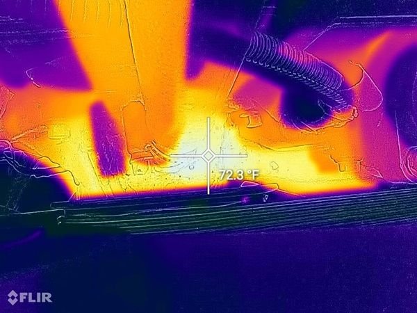

About 99% done installing this chinese diesel heater. it's on and it's working.
The good:
1. it is much less expensive than the german Webasto and Eberspacher
2. It gets the coolant warmed up very quickly, pics showing this below.
3. It is a very simple, easy to maintain heater. Found a video of a guy using one for his off-grid house cobble a replacement glow plug with a screw and basic tools.
The bad:
1. There are reasons it is much less expensive. It is very basic compared to the alternatives. no canbus, no dianostic software. When something goes wrong, no support.
2. it is less efficient. I don't yet know the fuel consumption rate, but with the smoke in the exhaust, I'm estimating it is considerably more than the German variety.
3. It draws more current than the expensive options. My old thermotop evo would spike about 10 amps during startup, then settle in around 2.4 once the glow plug shuts off. This one pulls just over 8 amps running. I didn't get the amp clamp on for the glow plug draw.
4. My webasto might haze a bit on startup if it is very cold but it would clear up once a flame was going. This china heater smokes on startup, but it only goes down to a mid sooty haze. must be a boost leak.
Having said all that, it is a much larger unit and really cranks out some heat. Today's test run wasn't on a particularly cold day; it got down to around 20 last night, and the engine hasn't been run before or during any of the testing.

Key on engine off, blower running about 12 mins.
Key on engine off, blower about 12 mins.

 engine off, getting good heat.
engine off, getting good heat. maybe 17kw was a bit much...

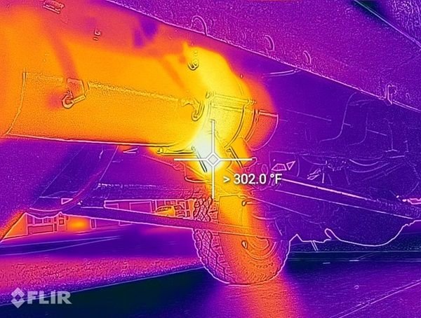

Gratuitous exhaust shot
Gratuitous exhaust shot. The FLIR built into my phone maxed at 302F. exhaust temp is much higher.
Your phone has FLIR built in?! What phone have you got?

ulefone power armor 18t. After my Note 8 split open from the battery swelling (what idiot thought making a phone out of glass was a good idea), I immediately searched for the "most rugged Android phone" and discovered a whole new world of
feature-rich devices I had never heard of. My first one was a Blackview BV9800 pro... I kinda bricked it messing with root. gotta have root.
So now I have this one. And I use it all the time as a troubleshooting aid that pays for itself in prop heat and bleed air leaks.
