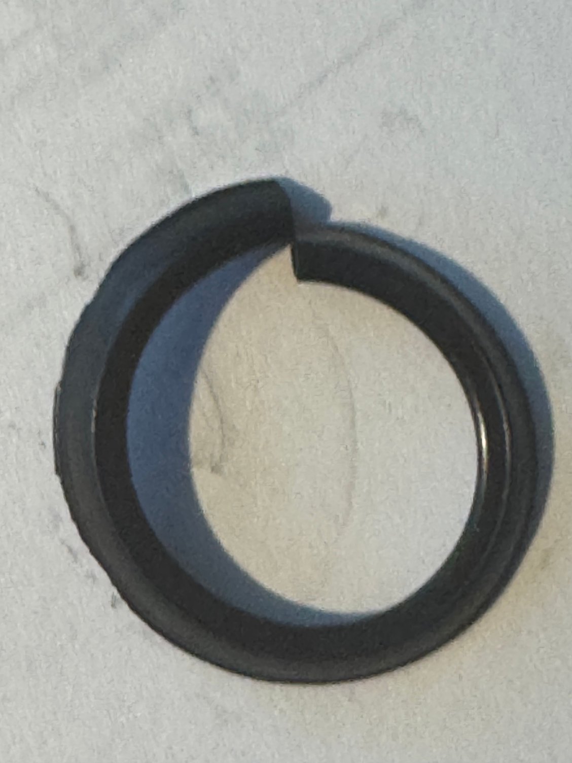

Trying to chase down a PS pump leak at the valve (which goes into the pump) which the high pressure hose goes into. I removed the high pressure hose and yes I will be changing out the white plastic o-ring the hose has ....but my issue is locating the beveled seat gasket on the valve that seems not sealing properly. Does anyone know where I can find that beveled seat gasket or what kit I can buy that brings it?

No..its not the plastic washer that goes on the hose. See above, just uploaded it

Are you talking about the spool valve fitting that threads into the pump then the hose threads into it? Pretty sure that just a standard o ring, if not though you should be able to go to a parts house and ask them for a rebuild kit for your pump. last time I bought one, maybe 4 years ago, they were maybe $10. It should have the seal included. Actually there isn't much else in the kit.

The bevel seat gasket goes on the valve pictured with a blue cap on it.

This piece here, the o ring I'm pointing at with the wire?
It's just a standard o ring, it may be deformed from years of pressure and heat but still just an o-ring.

Yes sir....but it does have a bevel on it. Check out the reservoir by itself and you can see the beveling there too. Last resort, I can try an o-ring to see if it works.

That might be something you'd have a hell of a time finding. A standard O-ring might work if you lube it up real good. I never actually removed that off the old one because the front seal was leaking so in went a new pump (and high pressure line that runs off of it.)

So I went out to Advance Auto Parts and got the PS Pump rebuild kit which cost me about 6.00 dollars. The kit did not contain the original beveled o ring but the kit did have o rings that I used. So far after the install...no leaks.
