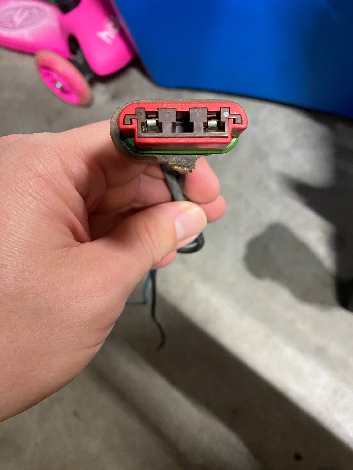

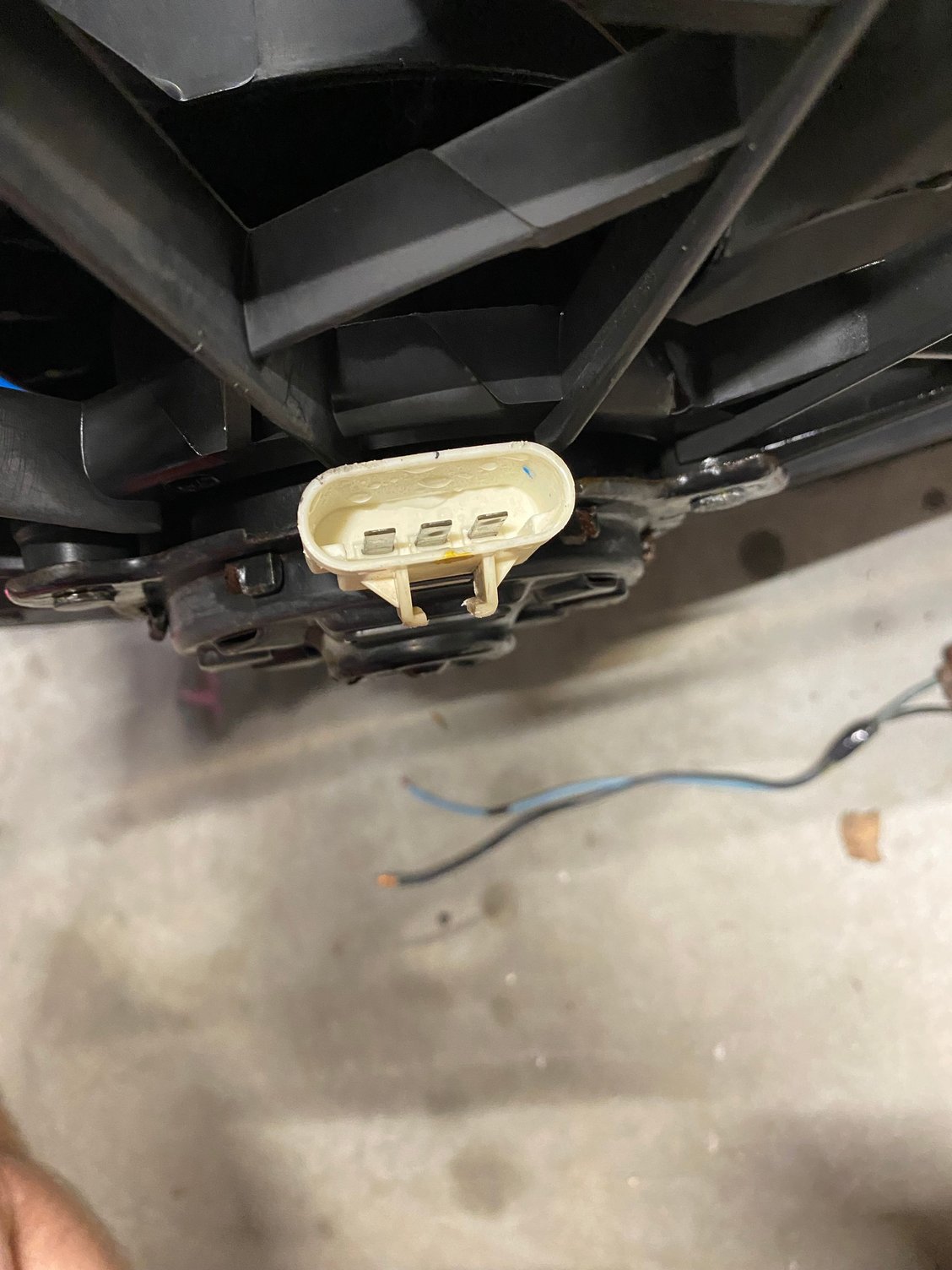

I FINALLY GOT A MARK VIII EFAN!!!! Those cars never show up in the local junkyards. This is only the second one I’ve found in the last five years I’ve been looking. The first one was already pretty well stripped. The fan I grabbed I need help with. The plug on the fan has three pins but the wire plug only has two wires and two corresponding pins. Is the fan two speed capable but the car was only setup to do one speed? I tested the fan by touching the wires to my battery and it seemed pretty fast. So maybe I don’t even need two speeds?

Does the fan have 3 wires from the plug to the motor? If so, it is a two speed fan. Test it.

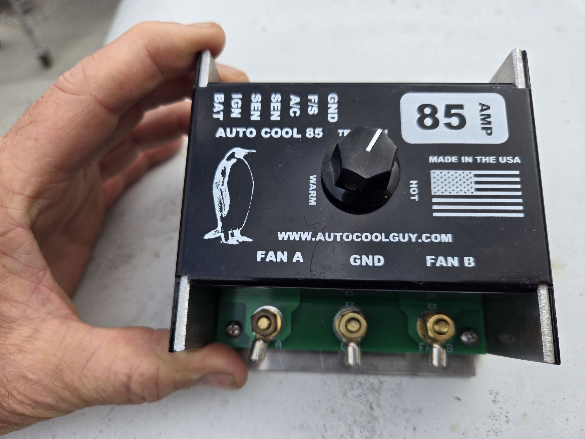

If I were you I would go straight to www.autocoolguy.com and get one of his soft start, Pulse Width Modulation controllers. For about 5 years I ran relays on my fans. Every time the fans turned on my engine would hesitate because of the spike the fans drew to turn on. Then, I tried this autocoolguy controller and I never even hear the fans turn on. Temp stays at a constant set temp. It was also easy to wire.

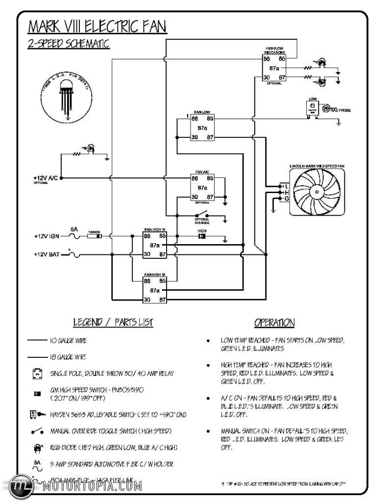

But, if you want to go with relays, use the Volvo relay pack. It is cheap, able to handle the amps of your fan, and, together with a bmw thermo switch, will turn your low speed on when the themp hits a certain level, then, if the temp climbs higher, the volvo controller shuts off the low speed and turns on the high speed.

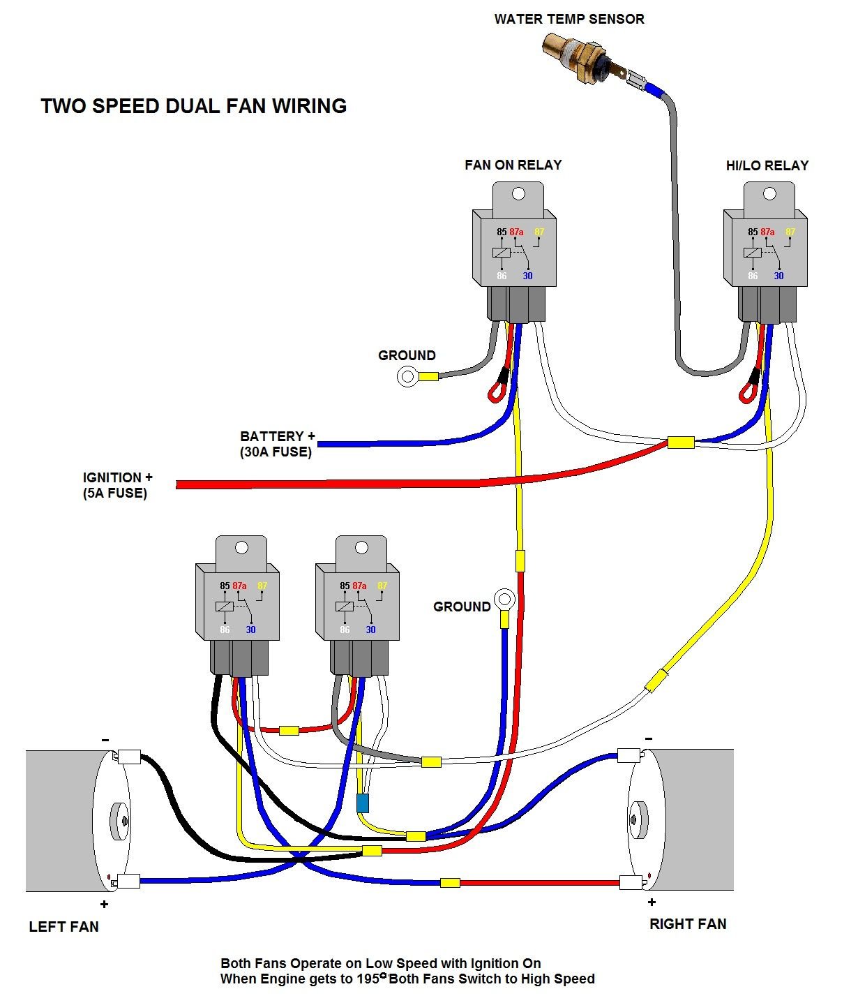

This shows it wired with a kill switch for 4x4 owners for water crossings. Or, you can trigger the relay with 12v keyed power.
That control relay needs to be 40/60 amp for your fan. Don't cheap out with that relay or with your wiring. That power wire needs to be minimum 10gauge wire. Good luck.

F250 restorer, that controller sounds legit! I’ll have to price it out first. I currently have the 3G alternator, Volvo relay and BMW thermo switch, but I grabbed two fans from a Taurus and THOUGHT I wired the smaller one has the low temp fan and the larger one has the high temp fan. I don’t think that is working correctly bc the other day I got stuck in a drive through and it was stumbling coming out of the parking lot and actually died when I tried to accelerate. I let it sit for 30 minutes and with jumper cables it started back up and drove home just fine. Im swapping the dual fans(probably lower cfm) to the coveted Mark VIII fan. It should be a simple swap since everything else is there, right?

And come to think of it, my truck has never gotten hot either, and I, like you, have single speed fans. I have a dual 12" fan setup from a 2000 Contour. Although Ford had it wired so that the low speed went through a resistor, and when the ac came on, the fan got full juice, or high speed. When they jump right to high, I used to get a 70amp spike, but no longer with the soft start controller I now have.
