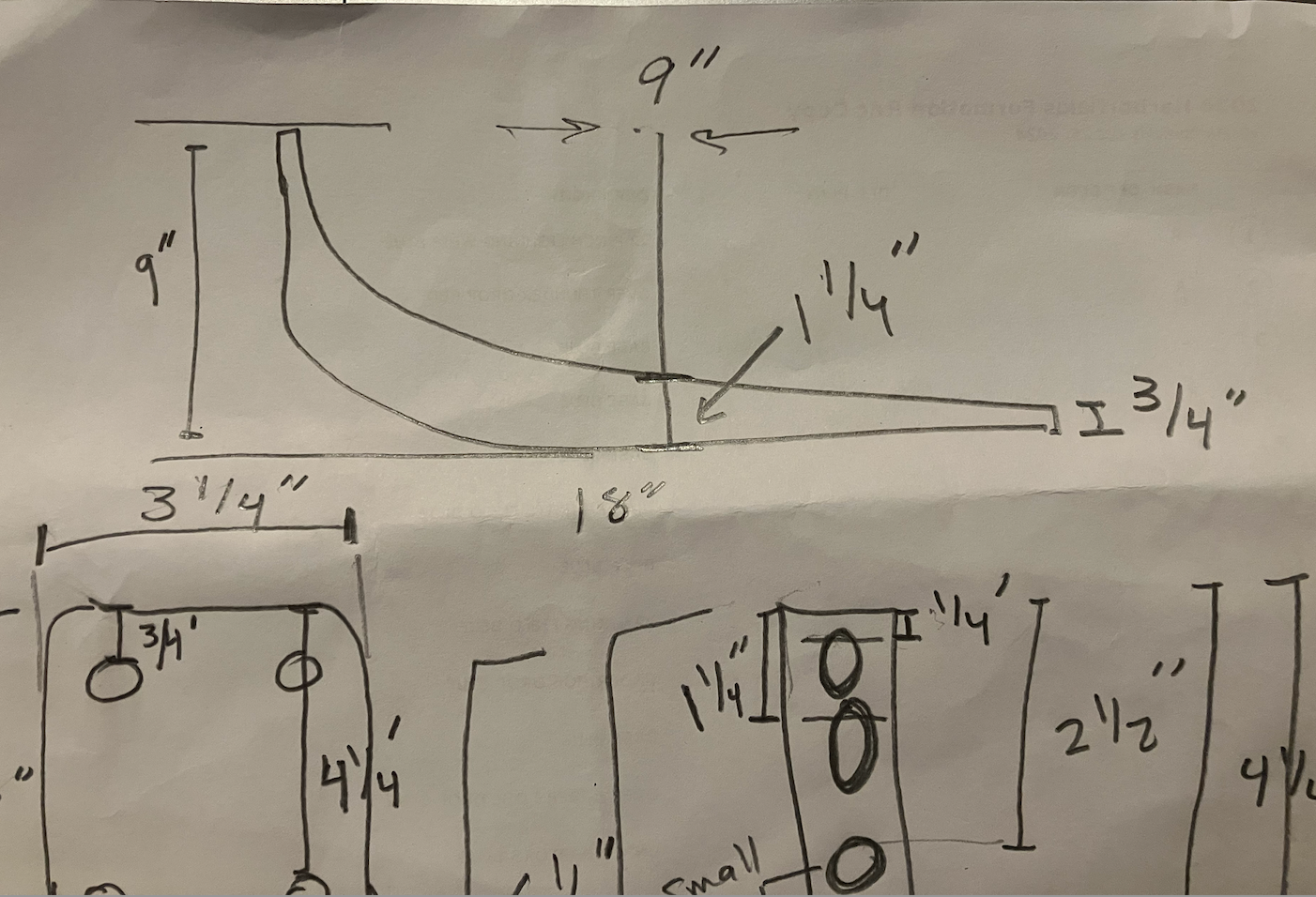

I bought these on Ebay. I notice one is longer and has different holes. I think the the holes would match up when installed. Would I need to cut the longer one down? What truck is it for?

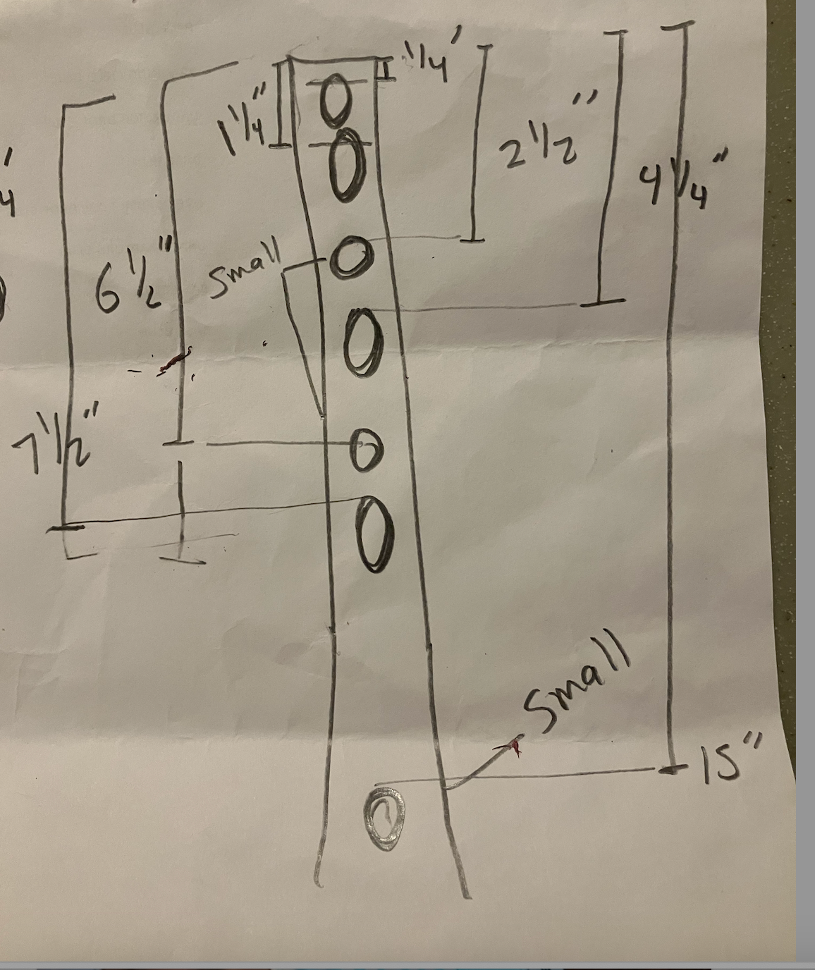

If I understand correctly the longer one is for the short style running boards used on the flatbed F-1 - F-3 and the larger trucks. If you can will you post up the overall length and hole spacing from where it mounts to the frame. I need to fab some for the truck I have now,

@jnkyrd1 hope that helps

Thank you. Yes that will definitely work. I really appreciate it.
