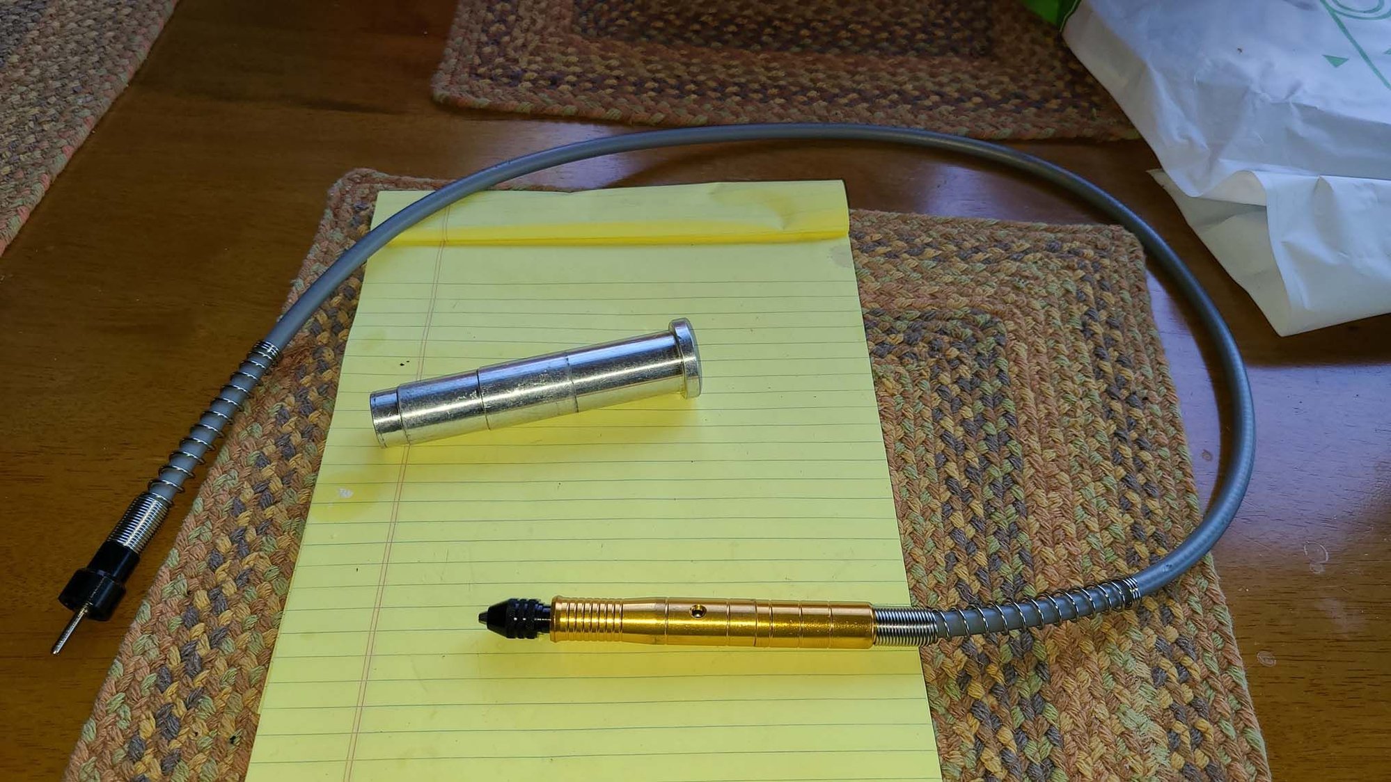

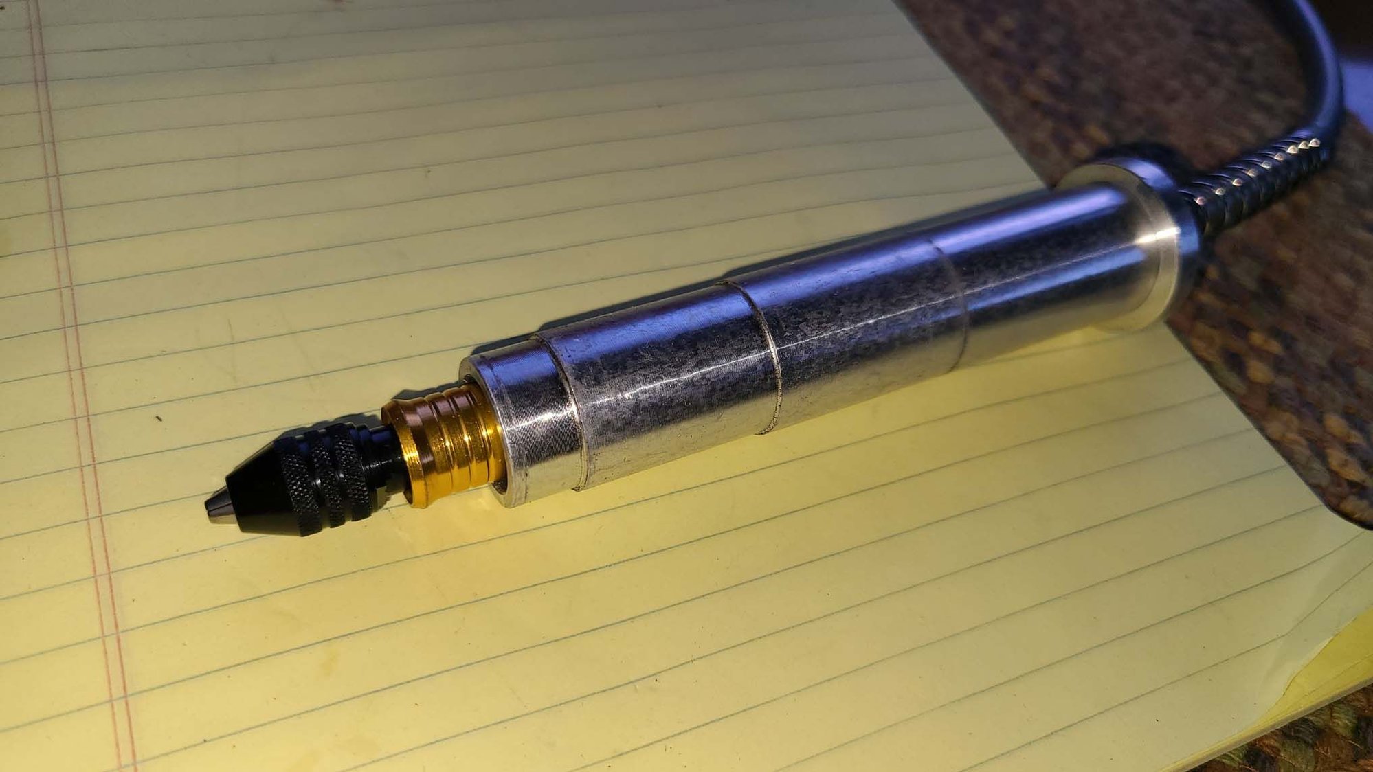

Amazon sells a Dremel extension that fits exactly into the Lisle guide tube. You then use 4mm titanium bur bits to remove more of the electrode, then proceed with 4mm 60-grit diamond bits which will remove the electrode and porcelain.

Here is the Amazon extension - it cost a whopping 13 bucks and saved me thousands.
Inserted into guide tube...
The entire job took me two weeks but saved a costly head removal.
NOTE: before using this setup, you must sand the nurls off the Dremel chuck (they come off very easily as it's aluminum) or they could gall your spark plug threads.
