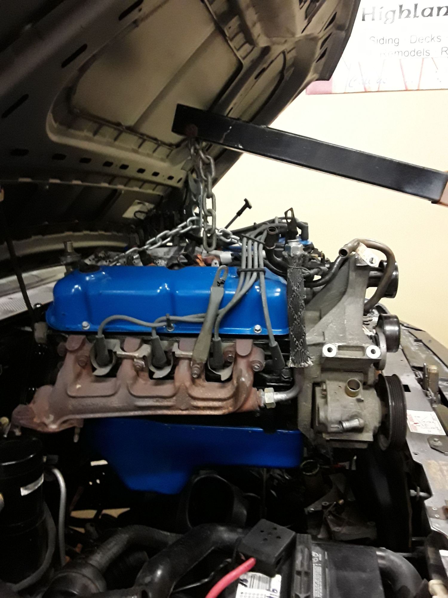

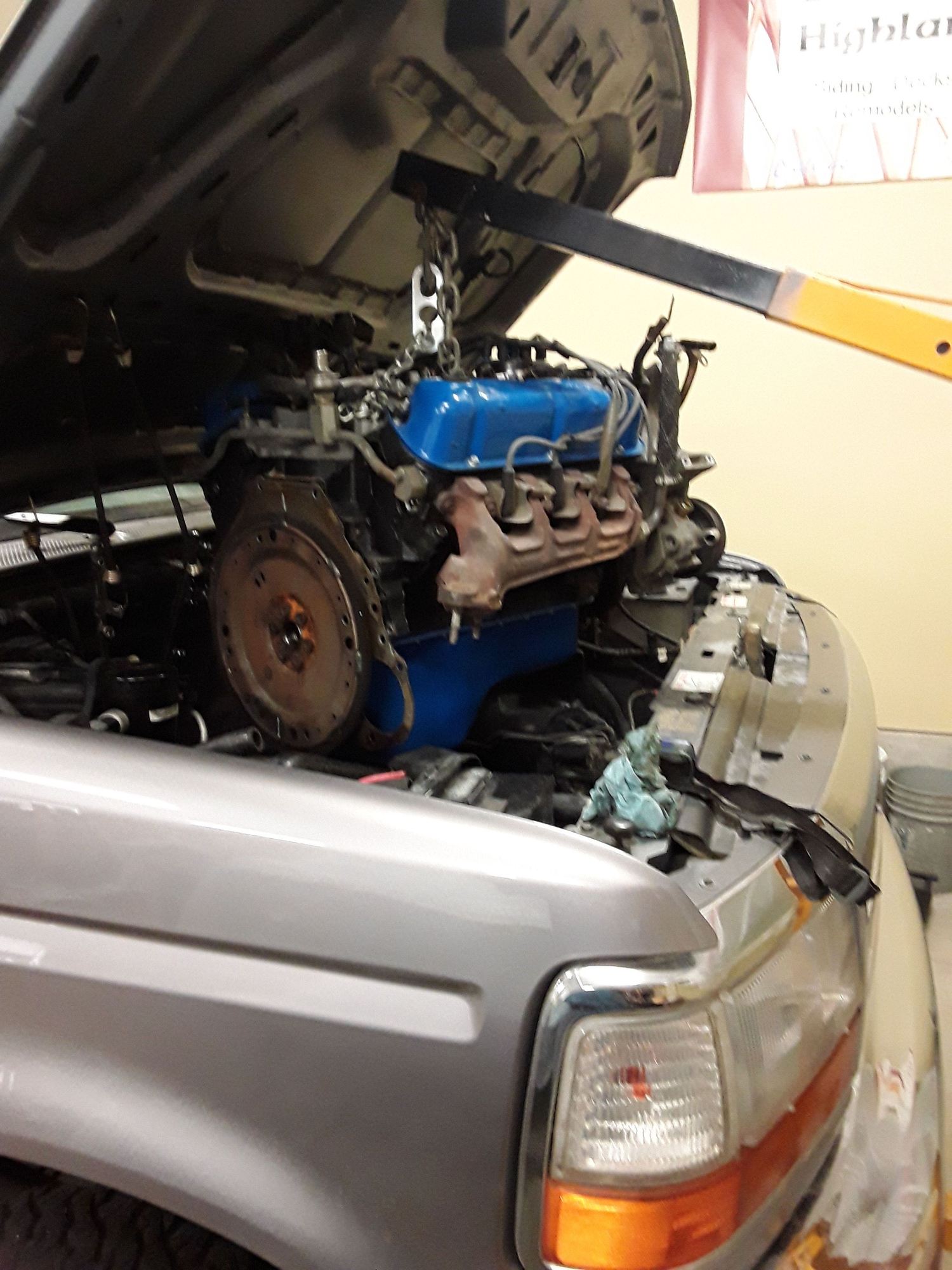

I removed the 351W out of my 95 Bronco with the hood in place and all by my lonesome.
Took less than 3 hrs from the time I pulled rig into garage until engine was on a stand.
Need to remove the radiator and place a pc of cardboard to protect the AC condensor
Just need to shorten up on the attachment chain and rotate the engine on the way out while rolling the truck back a little bit to clear everything, which is easier than rolling the cherry picker once it is bearing weight:
