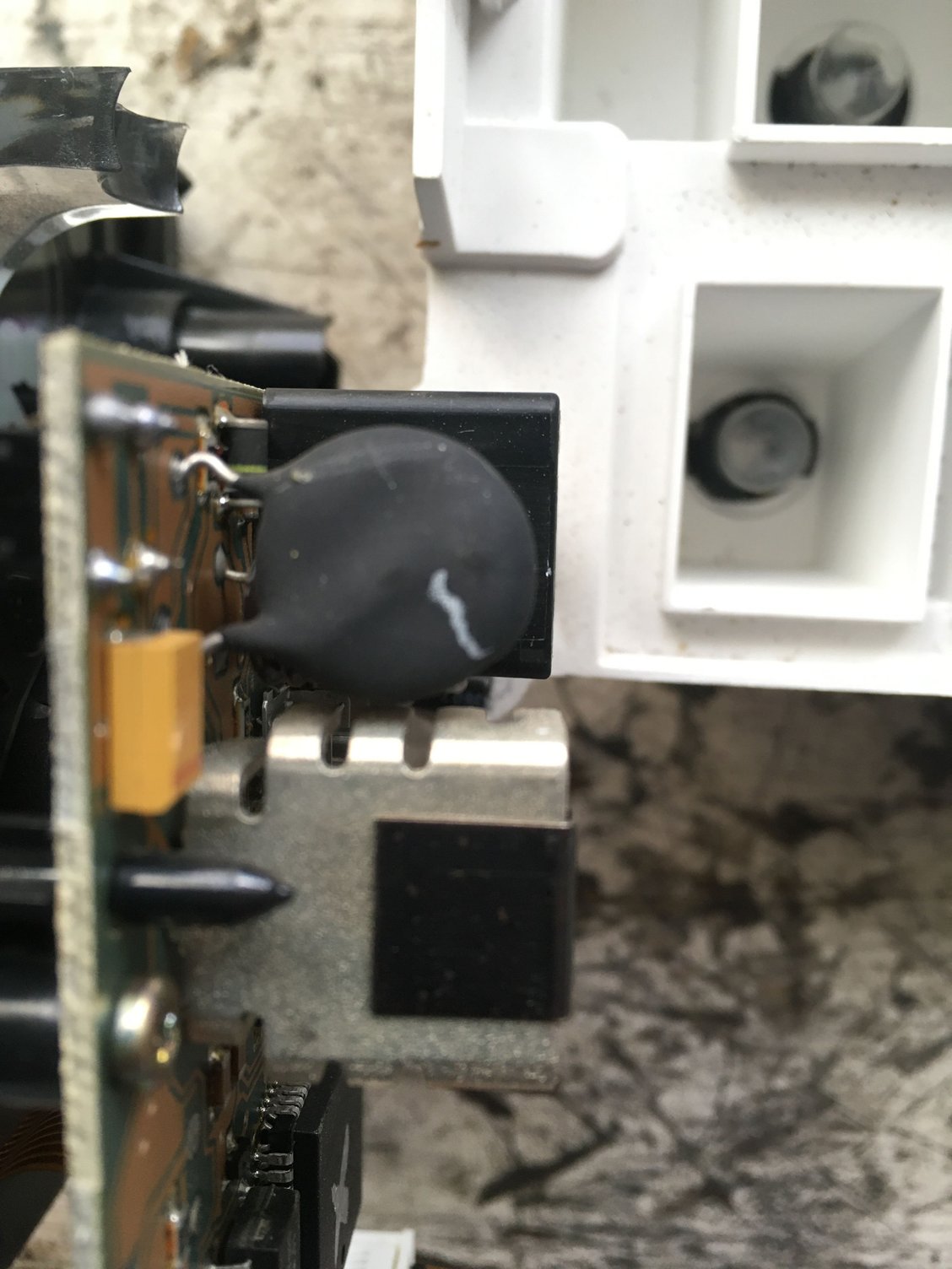

Went ahead and peeked at the psom before I put everything back together. The black disc has a spot near the top left, close to where the wire comes out, that looks like it is oozing something, and left a smear/streak when I wiped it with my finger. Also not sure if that white squiggly line is supposed to be there either? I saw a YouTube video showing these components, and part number info, gonna have to watch them again and maybe replace this part?

A dead speedo and a blank odo is caused by one of two things, fuse 8 or 18 being blown or a bad PSOM. Most folks will ship the PSOM to have it repaired.

If you need a PSOM for testing or for quick repair, any 92 & up works with 95 & up resisting needle shake the best.
You'll loose the mileage, unless a chip is de-soldered & transferred, but it'll get you operative.

Right now it works. Maybe pulling the fuses broke the corrosion? Maybe I’ll keep an eye out for a psom, it’s not too hard to get to… I’ve soldered boards before, the black disc is the only suspect piece I see, shipping is about 8 time the cost of the part…
