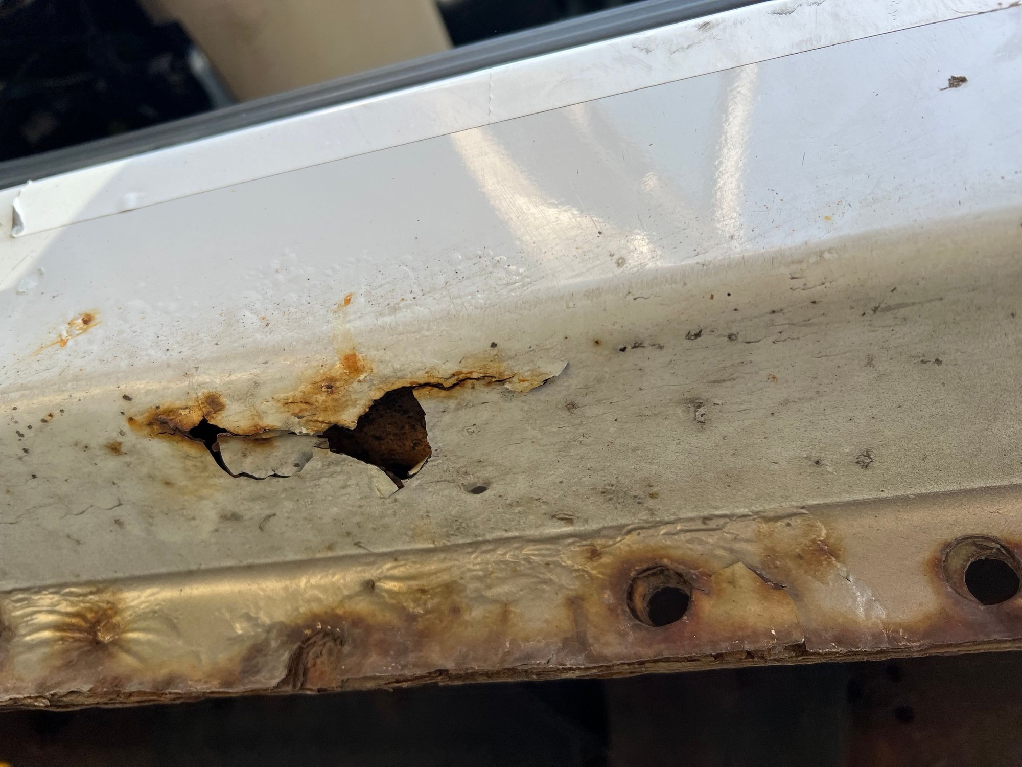

I’ve looked around and haven’t see a thread for what I am asking. Sorry if this is a dupl. I have rusty outer rocker panels and underneath also. It’s gotten soft to where I can poke my finger through on the bottom. How big of a deal is it to fix/replace these, and am I looking at a significant amount of money? I also have some bottom door rust. I still love this truck after 18 years and would just prefer to repair and keep structurally intact. Thanks.

Cut, grind, drill spot welds, weld, grind some more, bondo/seam sealer, undercoat, prime, paint.
I am guessing you dont have the neat tools since you ask how big of a deal it is to pull off. Gaurantee the rust goes deeper than you think. Doors and wheelwells doing the same thing? Cab and bed mounts?
I just sold my 01 because the repairs were rotting out again.

Depends on tools and what you have. Not hard if you have the proper equipment.

Yeah it's not difficult just time consuming if you have the tools and a good hand with a spot welder. If you don't a body shop can fix it but it's gonna cost you some cash because their labor rates aren't cheap.

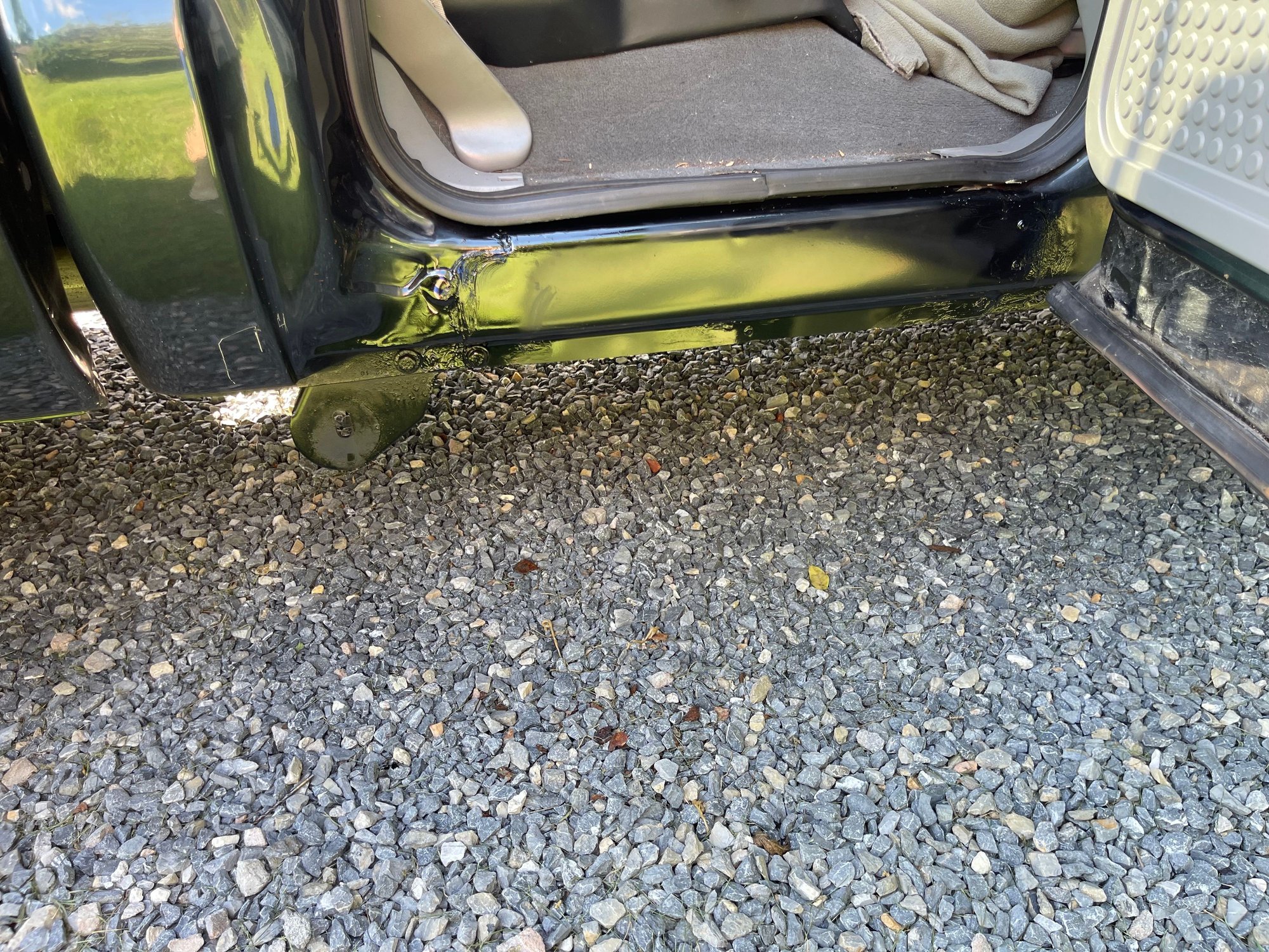

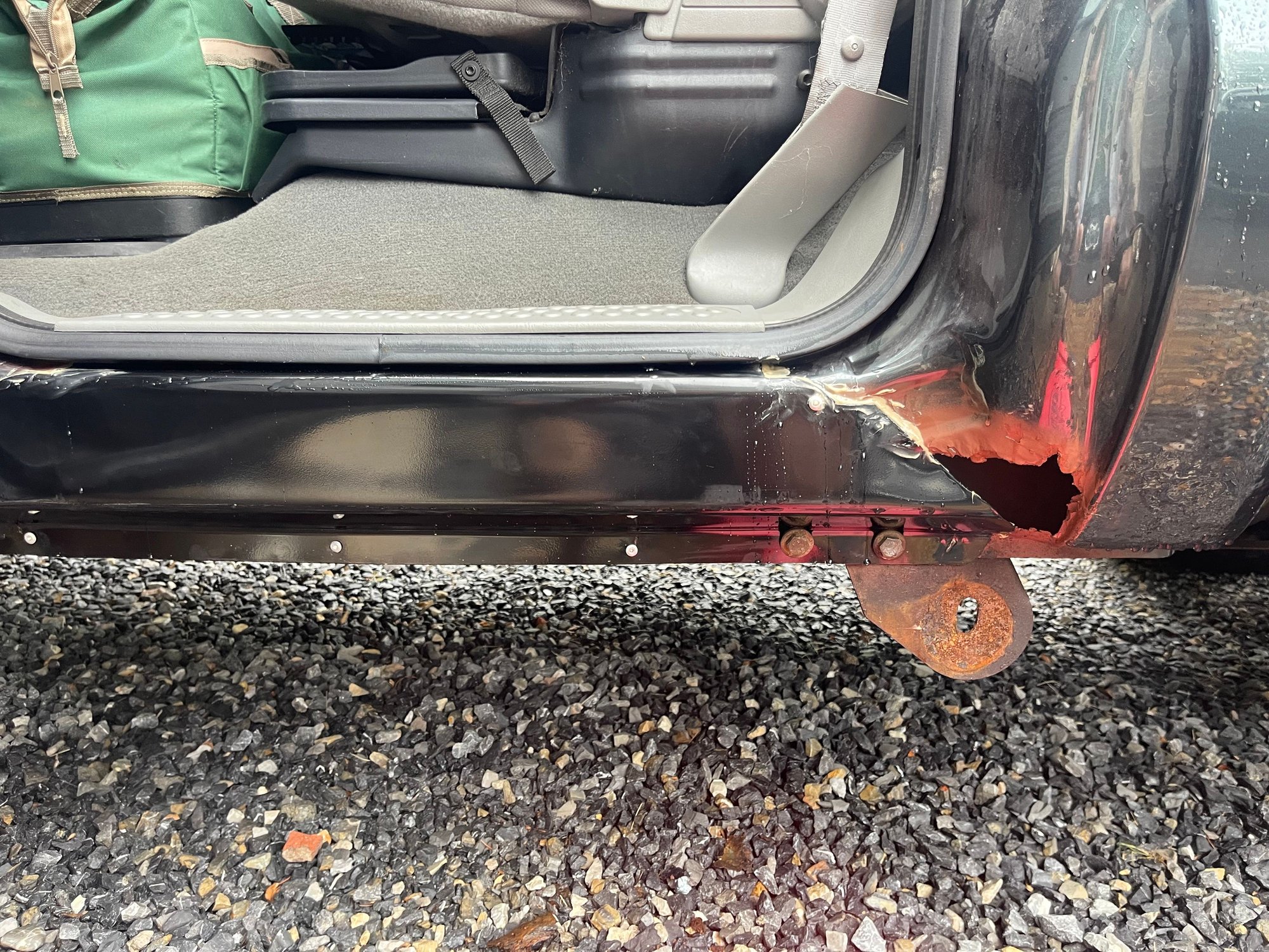

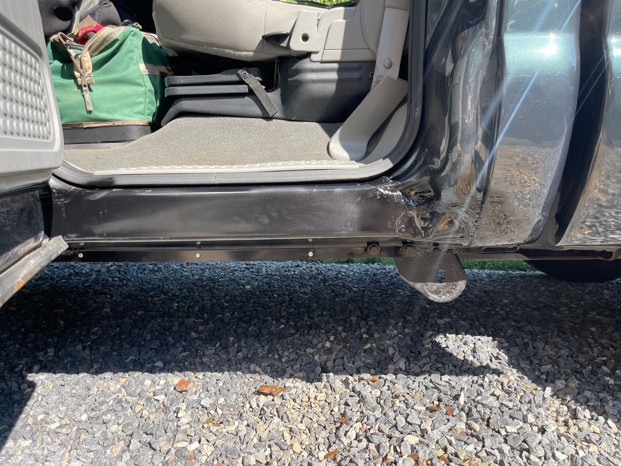

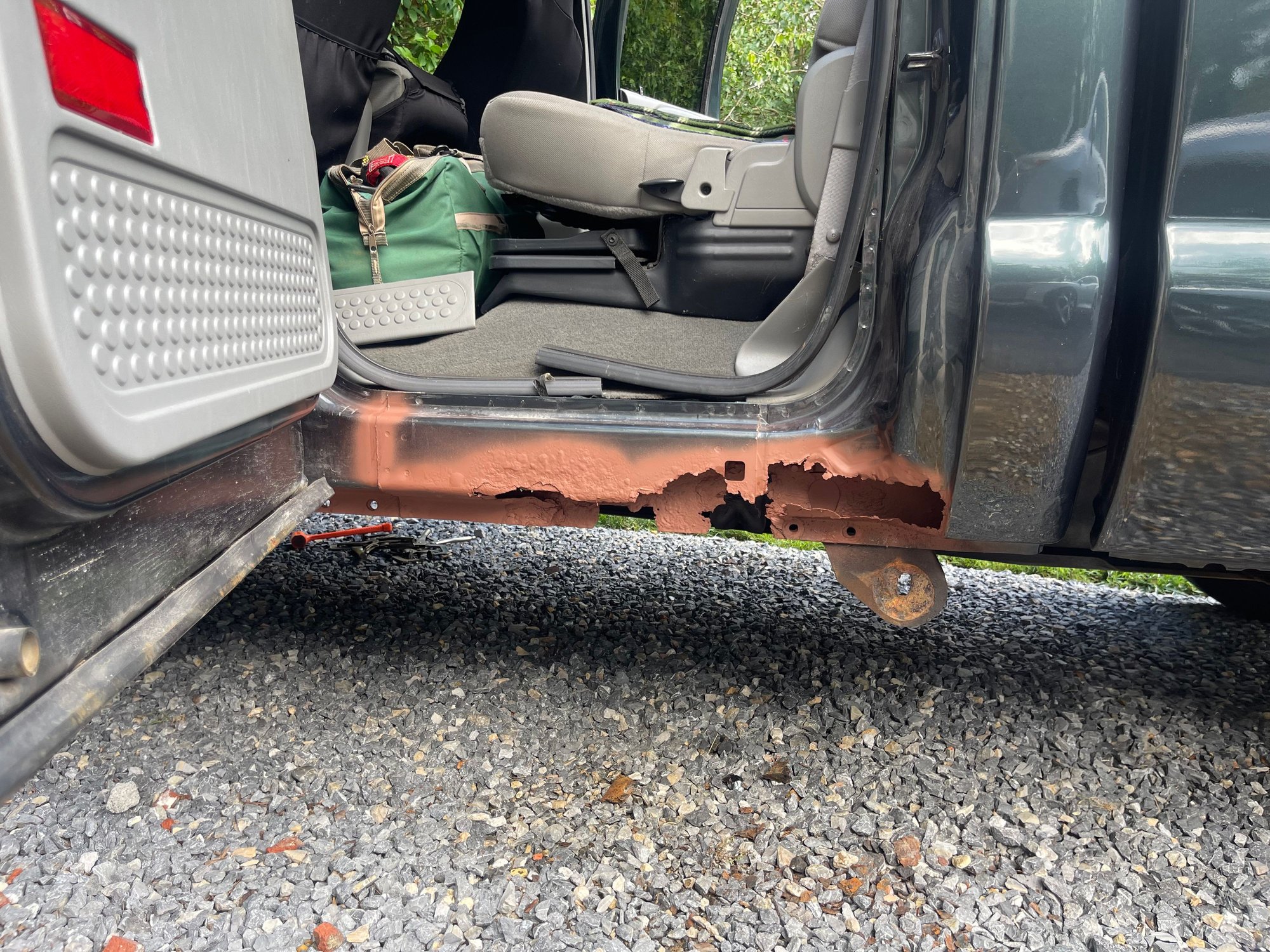

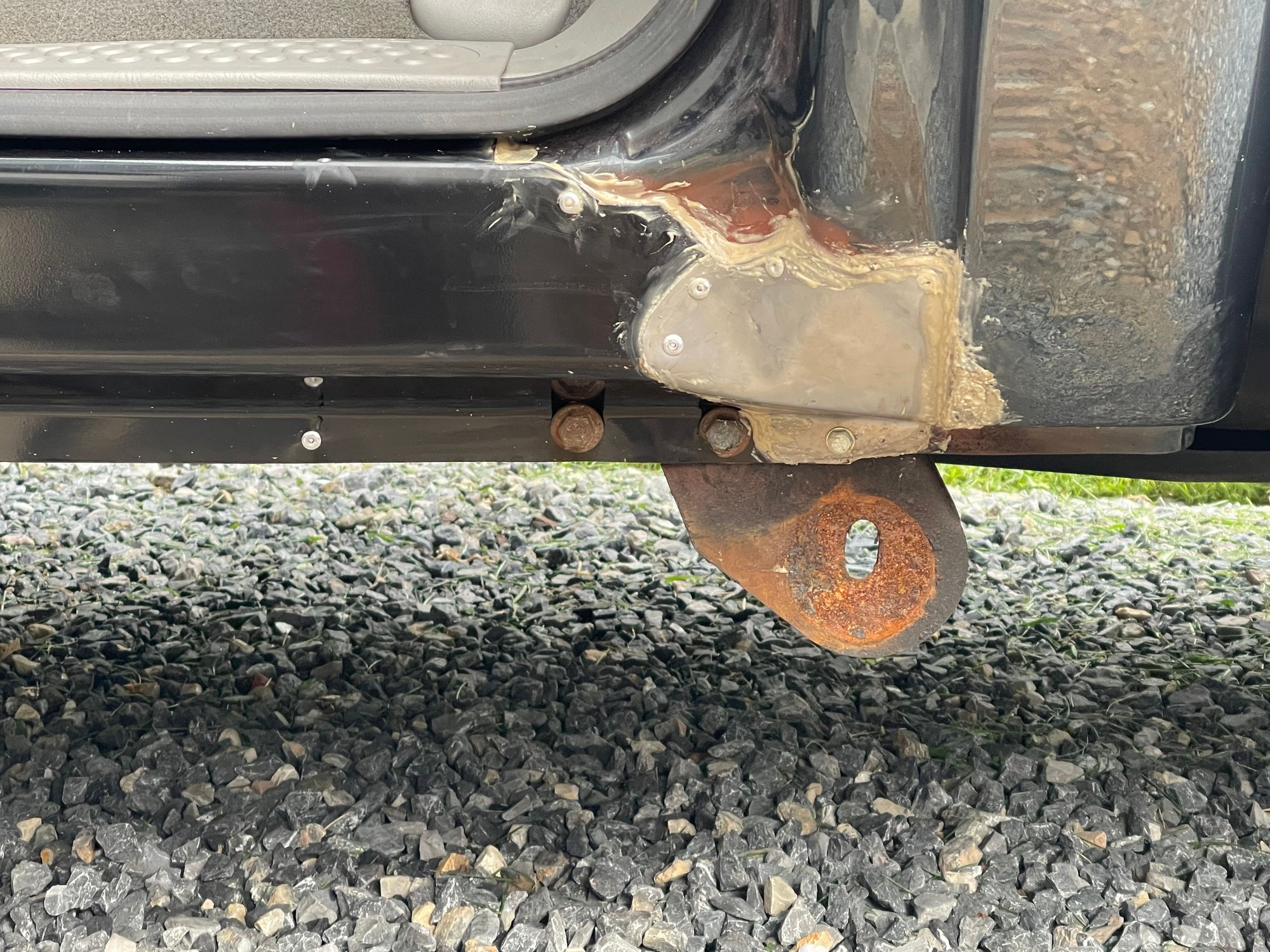

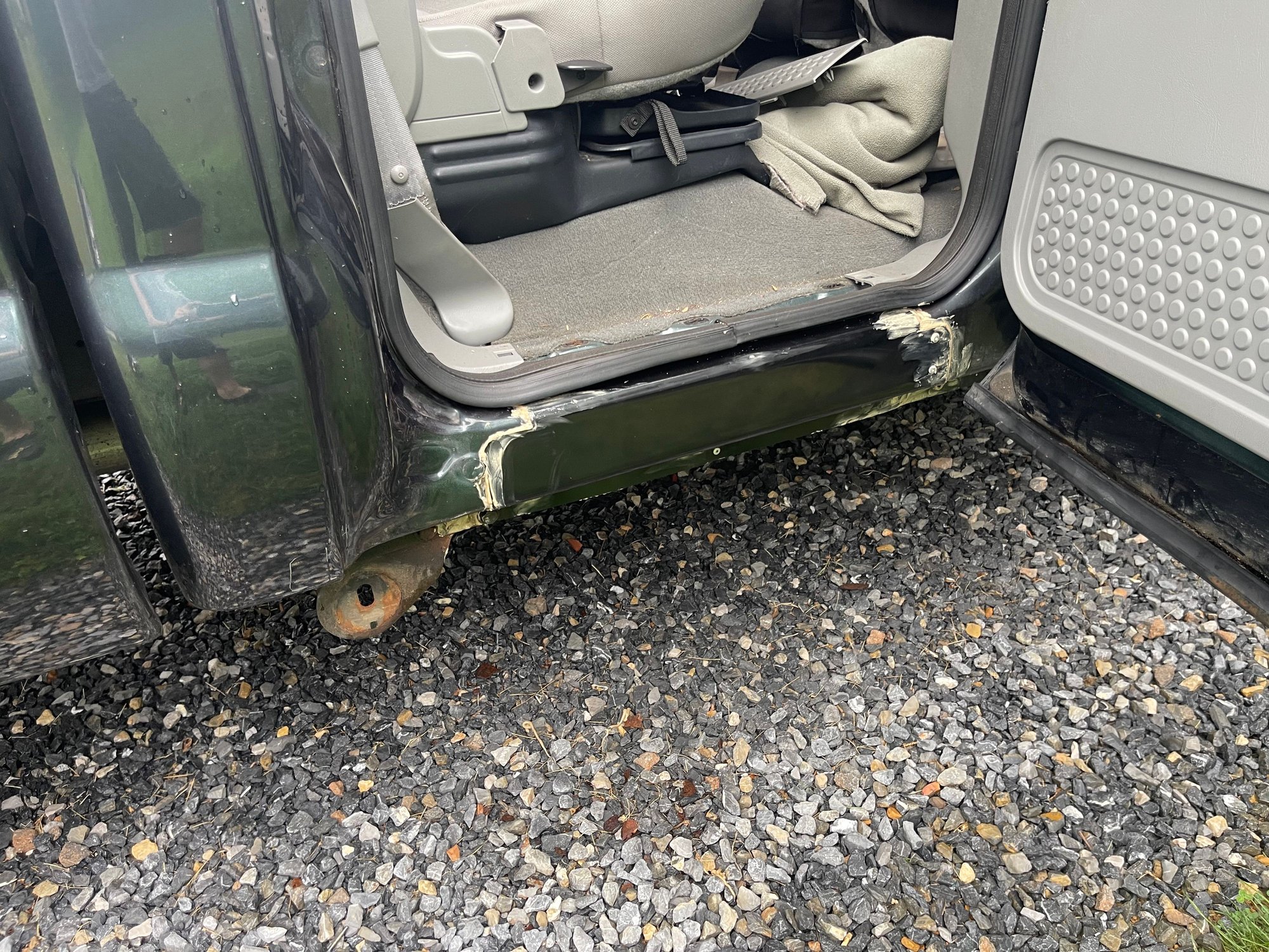

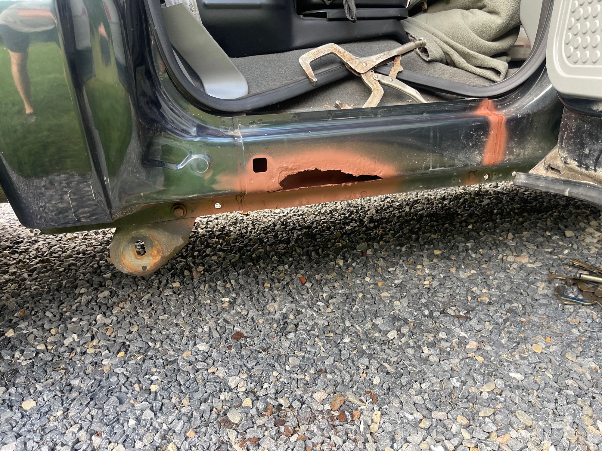

I did mine the unconventional cheap way. I didn’t spot weld them, I used rivets. I also coated the backs with PL construction adhesive prior to riveting. Getting them shaped properly was the hardest part. I’m hoping the PL helps keep water and rust from getting in between the old and new metal. Drivers side cab corner will be next at some point. I’m not looking forward to that.

Nice work!. Looks a lot better than before for sure.

The nice thing on these trucks is once the door is closed you never see them. My paint is a dark green, but I painted the panels black. Definitely looks better than the rusty holes. Now keeping the lower door seams and bed seams looking good? Thats a whole other ball of wax.
