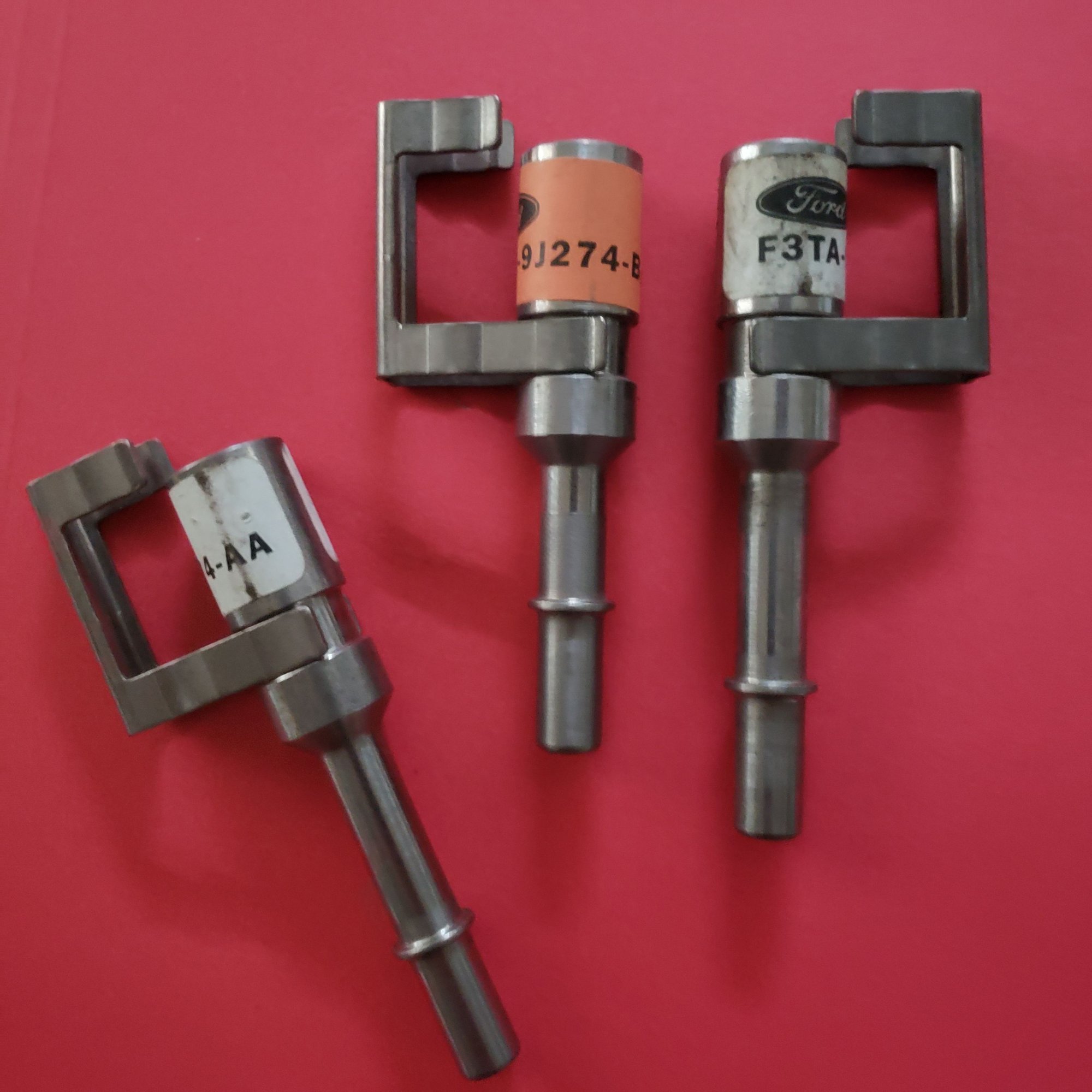

Maybe look for one of the old recall one way valves for the fuel transfer or keep replacing pumps
I found one of these for a 2004 I previously owned, I used to have a bunch of them
If both in tank pumps work, it is not as big a deal to have the fuel transfer
