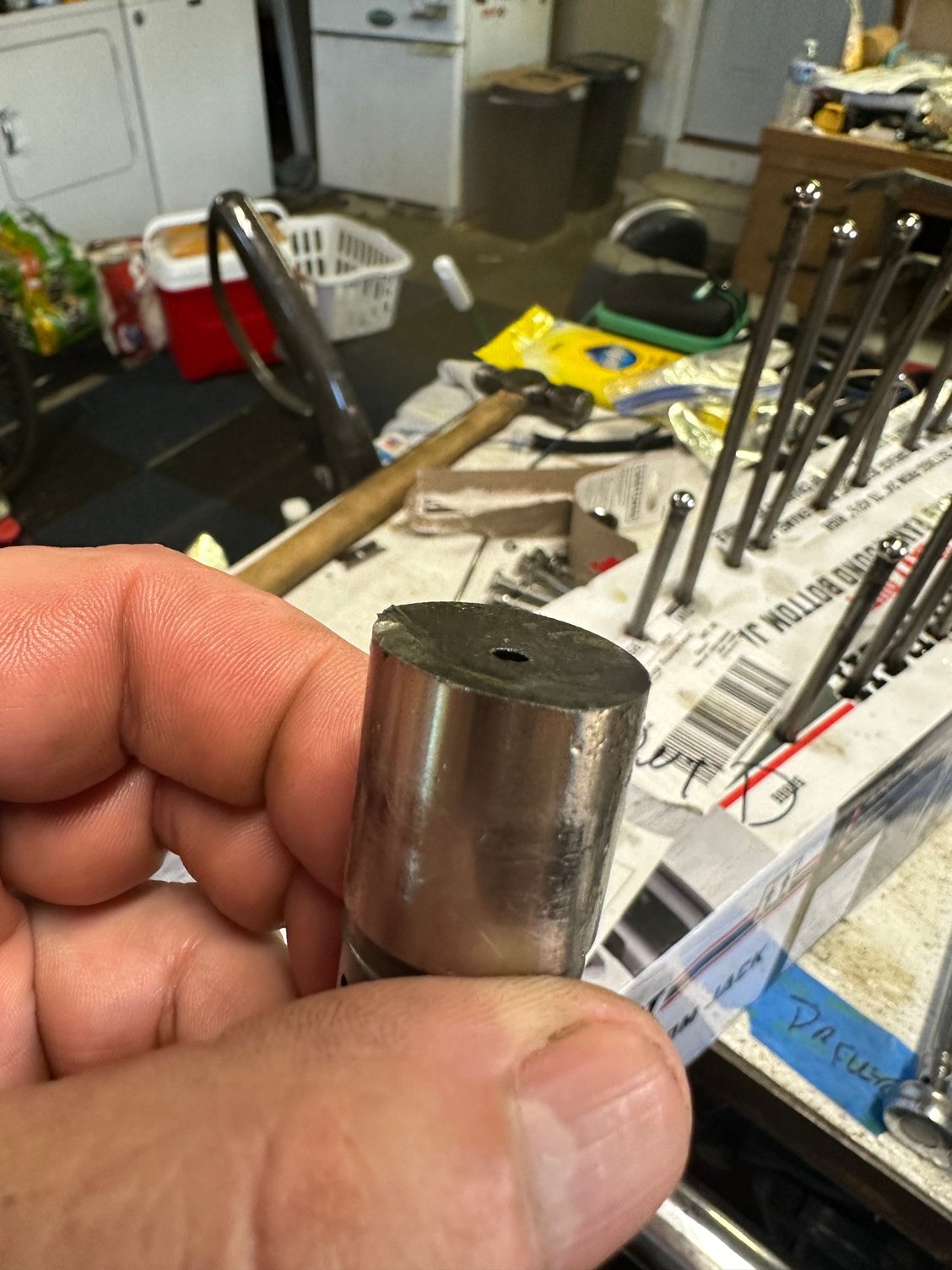

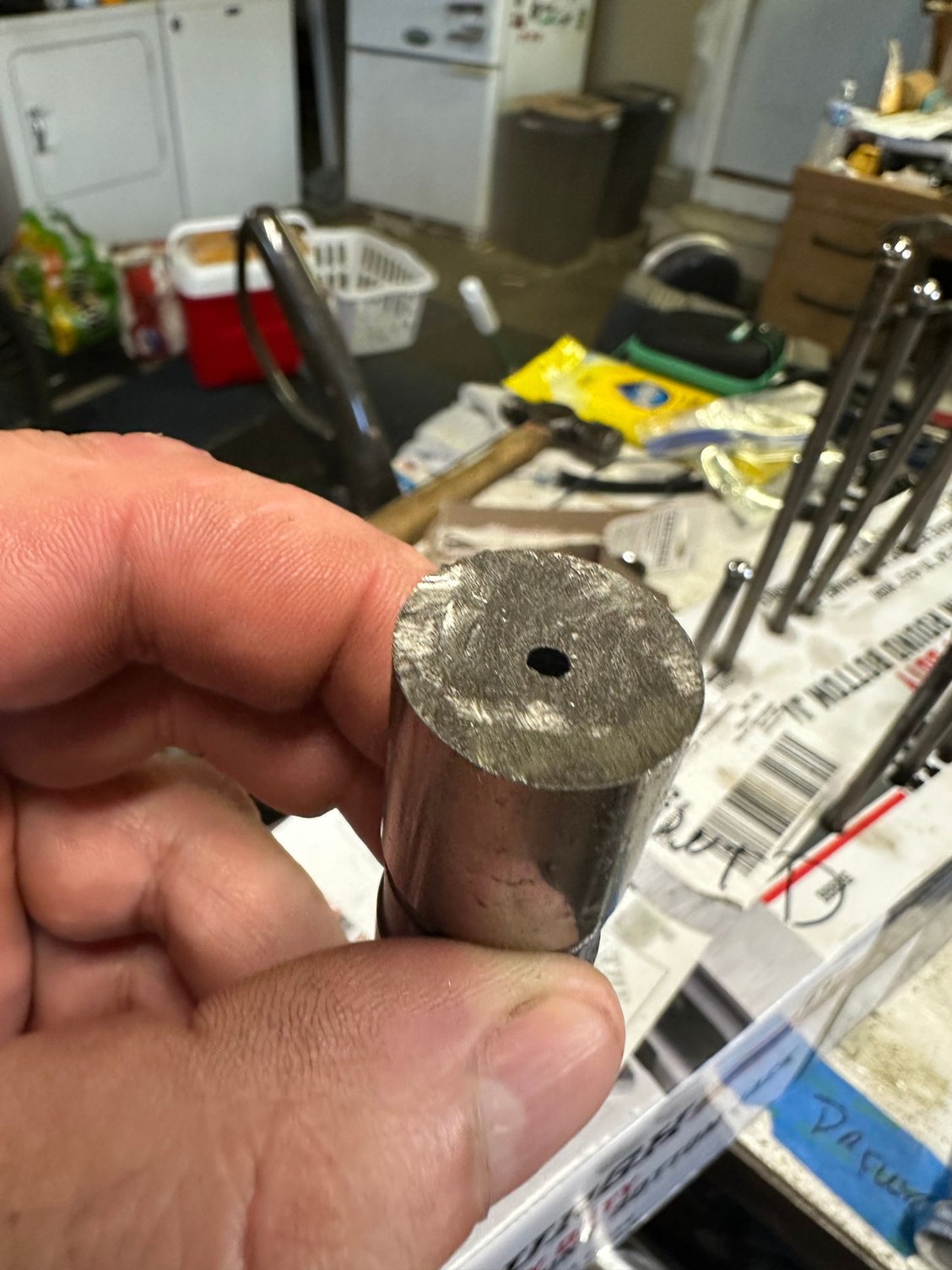

I just finished rebuilding my 390 for my 73 F350. Did break in, cool down, and changed oil. Ran fine. Sat for about a week got into it started it up. Idle rough, I could get it timed at about 15° in the idle would smooth out, but once trying to drive it, there was a lot of hesitation it wouldn’t go anywhere. Anything off idle would cause a sputtering and a backfire through the carburetor. I thought it was the carburetor at first, so I had that rebuilt. Took off passenger side valve cover number three and number one intake valves not opening. The lifter was moving up and down, but it didn’t look like the lifter itself was pressurized. The cam looks fine. That’s not wiped out. I’m at a loss at what it is. Any help is appreciated.

I found the problem. Number one exhaust is wiped out. That’s why it didn’t pump up and it was back firming through the carb.
