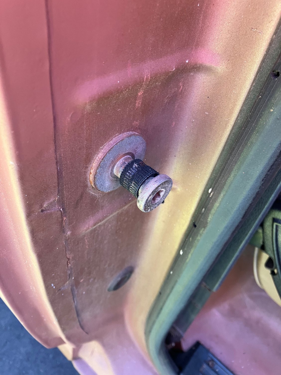

You say your doors don't rattle over bumps. Do your latch pins, have the plastic cushion ? I found velcro works well too.
Years ago, my originals were worn completely into two separate pieces.
The local Ace hardware, right across the street from our place, among all their many types of tubing on big rolls, sold by the foot, had some sort of very hard, very tough, very thick, plastic tubing that the I.D. was a dead match to the O.D. of the metal pegs.
I have no idea what type plastic tubing this was.
I cut two correct-length pieces --- he gave them to me --- split them lengthwise --- and replaced the much thinner worn-out originals with them; that was many years ago and they have far outlasted the originals.
