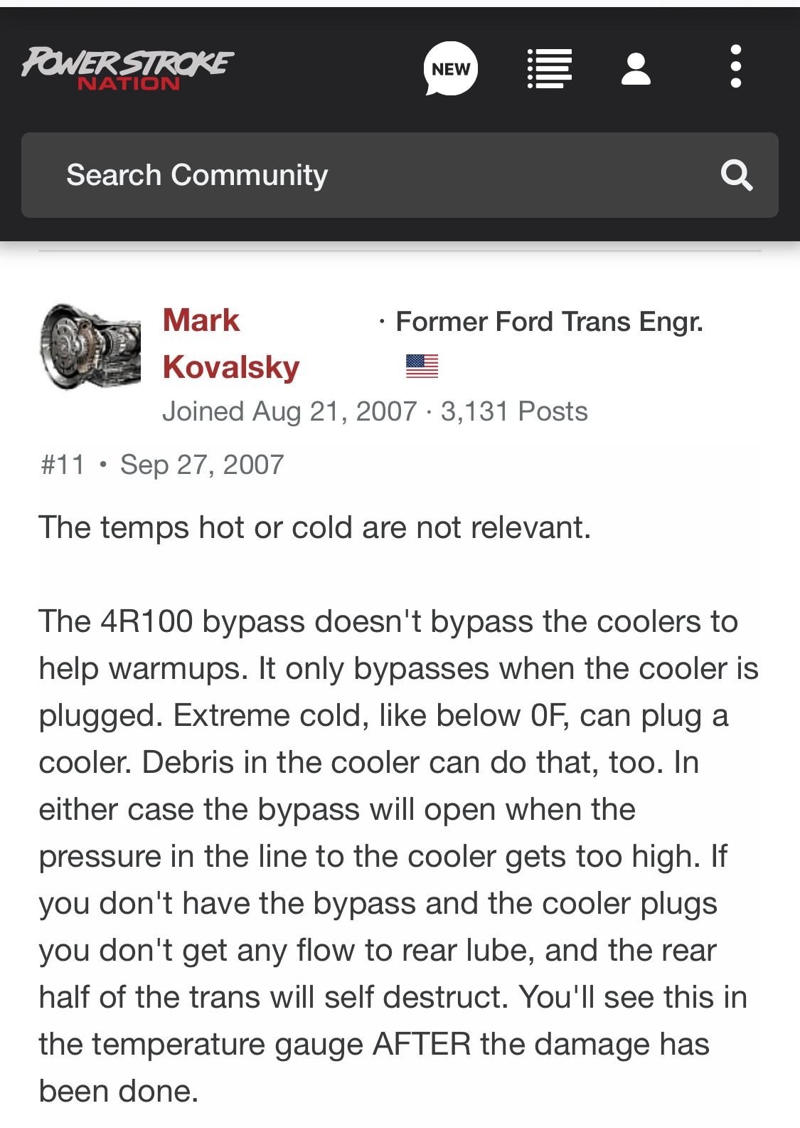

I'd skip the trans bypass delete. The bypass is a good feature to have if the trans cooler gets clogged.

I second keeping the cooler bypass.
