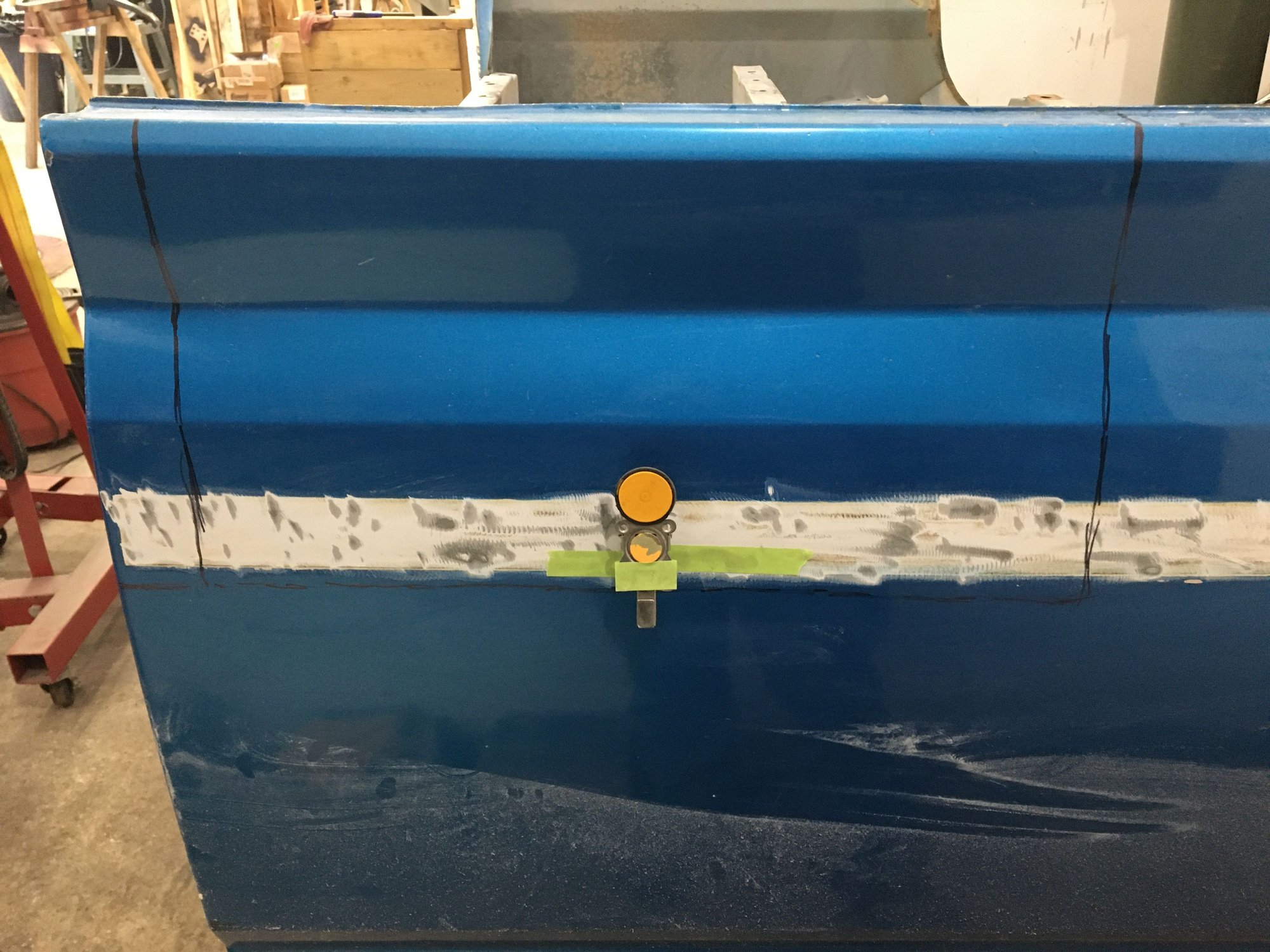

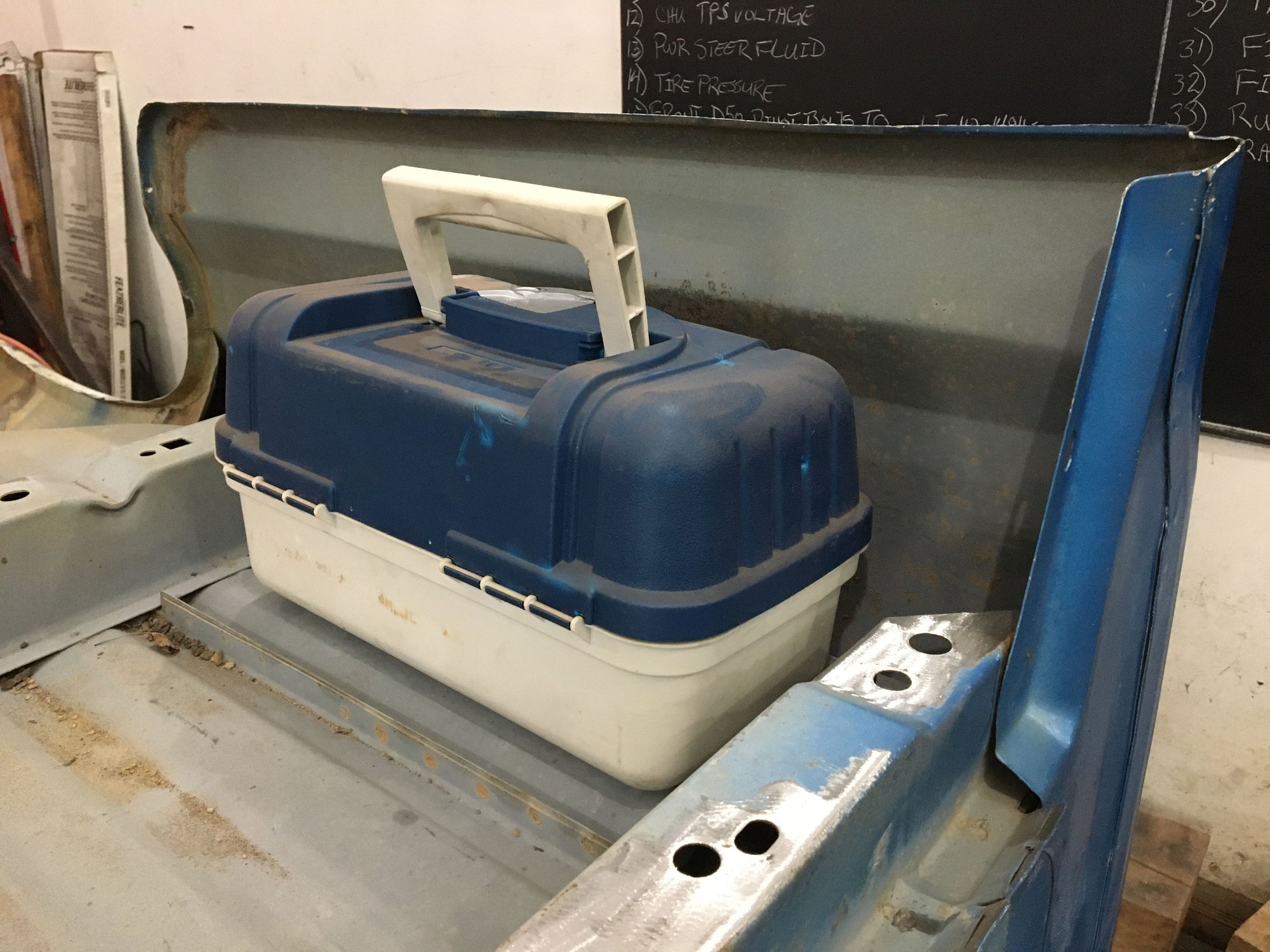

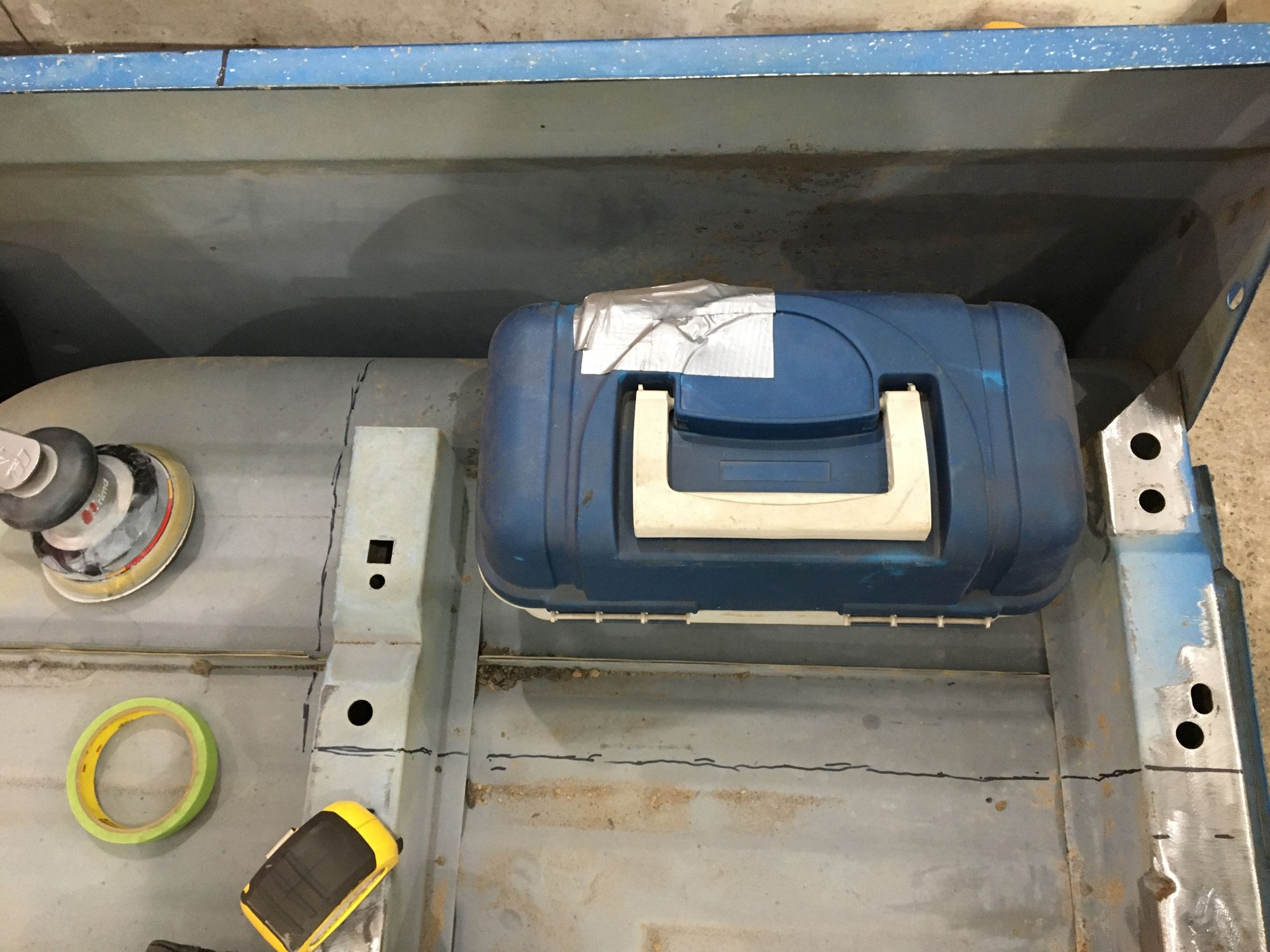

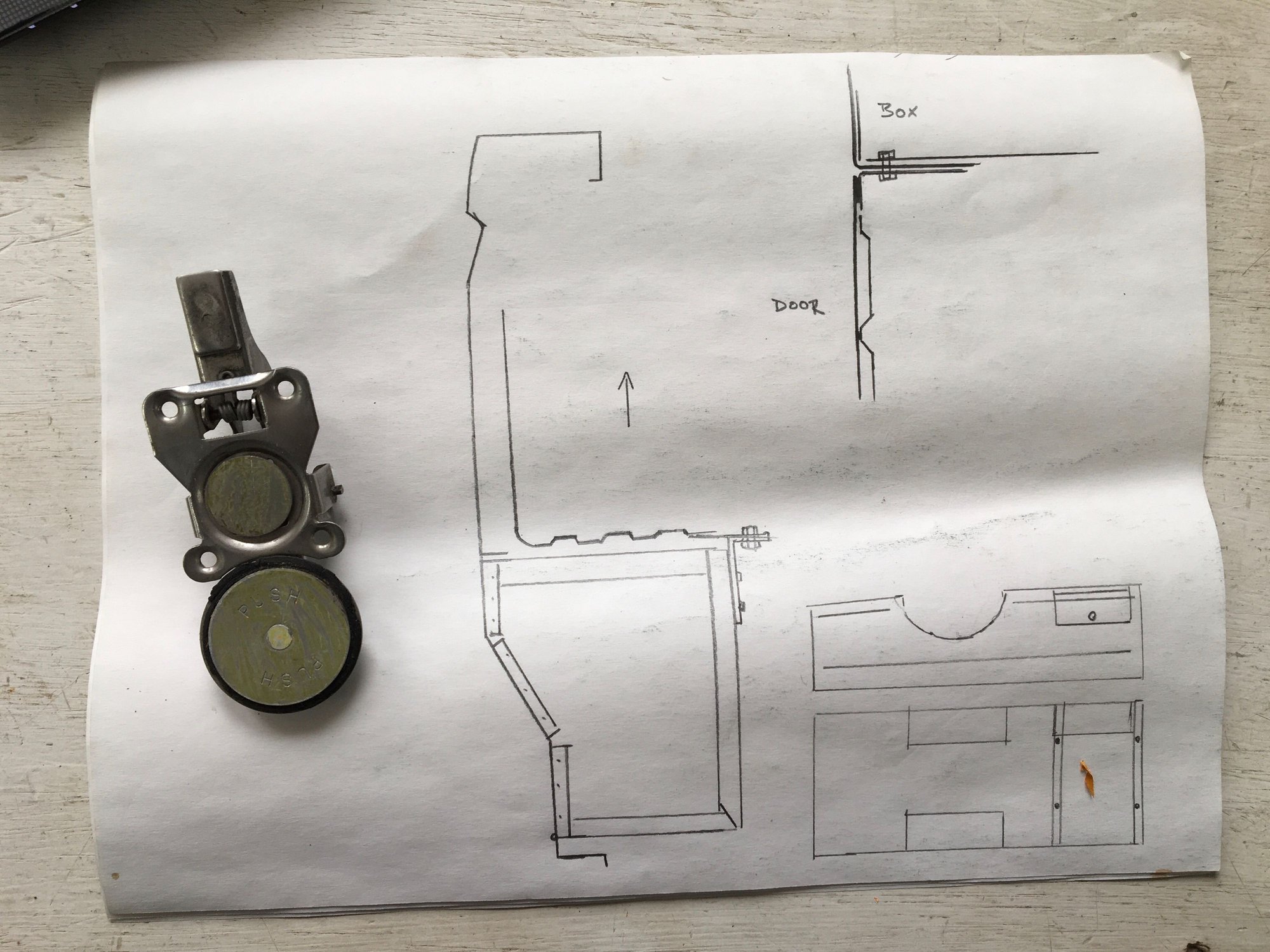

I thought about building a tool box, similar to what was in the 70’s on my OBS. By the the time you’re done, theres not that much space. Enough for a small tackle box, spare boots and gloves. Not quite the same dimensions and space to work with under there as they were back then. It’s not much different for space on the SD either, iirc, it’s a little less actually.
If you’re hoisting ‘cargo’ up somehow, I’d be concerned about how to secure it, or dropping out on the road.. you could secure it, but it would be a pita imho. Especially a propane bottle. Little different to permanently secure / build something in, vs storage spot to easily access or temporarily hood something imo.
a few pics from when I looked into it, OBS, but you get the idea. I haven’t done it, ‘yet’.. and I doubt I will. I’m not sure it’s worth it, and trying to get it to seal properly, small space, etc etc. Not much room before you’re into the frame. There’s was thread about this a few yrs back when I looking at it down in the OBS forum.
Pics from a few yrs ago..
I’d use two latches if doing it..
If you come up with something, post it up.
