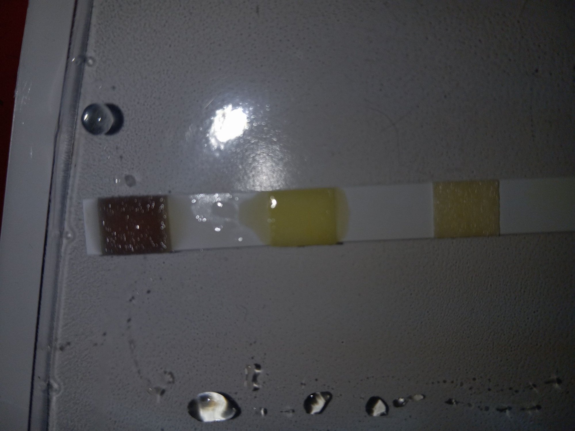

Okay I received the Fleetguard test strips and they have a good expiration date of May 2025. The sample in the hydrometer is to show what the coolant looks like. Using the test strips it shows adequate freeze protection but that's the only thing that makes any sense to me. open for suggestions at what I have going on. No idea what coolant is in the truck.

Based on what I see it looks like the OEM fill Ford Gold for 02-03 7.3.
I continue to run that since imo coolant is a consumable. ELC is better in every way, but it lasts longer than your waterpump/thermostat/hoses. Ends up on the ground anyway.
The Gold depletes SCAs but at much lower rate than green coolant. So it lasts longer. IIRC the yellow blop on your test strip is a good reading, but please compare to the bottle and let us know.

I agree I would just leave the gold stuff in there if the test strips say it's okay. Maybe at some point if you ever have to take the cooling system apart to do a water pump, that might be a good time to do a distilled water flush and and switch to the red stuff.

Here's the chart that came with the strips. The dark test spot at the bottom is for freeze point. I don't see where I get any reading for the others.
I used a strip on my diesel tractor's coolant which is plain green with WIX additive and the Molybdate panel turned pink.
Old May 16, 2024 | 09:26 PM
RA101725's Avatar
RA101725
Banned
Joined: Dec 2018
Posts: 3,541
Likes: 458
Looks like you've either got nothing or too much on your Nitrite. It should say which one is which on the test strip container.

Middle pad is Molybdate, the one on the right is nitrite.
