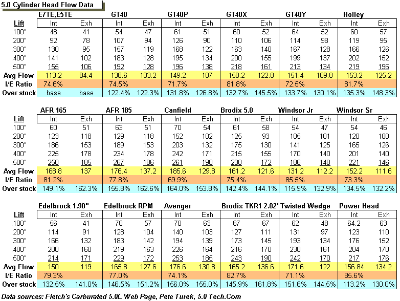

All those heads are an improvement from the stock E7's.. see the chart below. A word of caution on the super cheap far east head castings that are everywhere, it's entirely possible the machine work will leave something to be desired and I have seen it mentioned that some valves may not seal perfectly, so these heads often need a little attention before they are bolted on.
