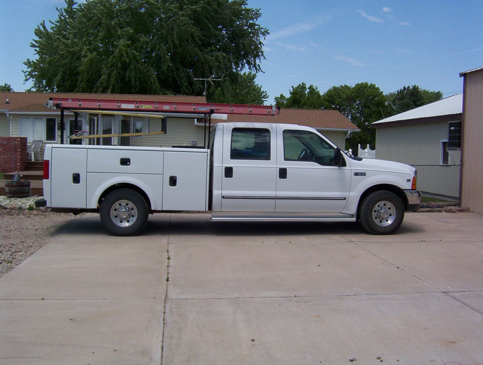

This was my last one before I retired, 2000 F350 V10 with 8.5 ft body. It's the only work truck I bought new.
wow that’s a nice lookin rig, sure it was great for work productivity, what kind of work did you do?
