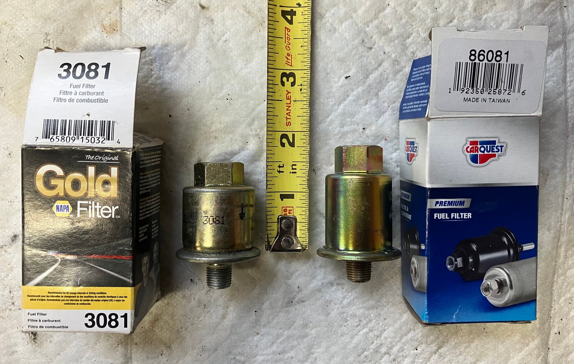

Boys and Girls,
I recently picked up a spare fuel filter from Advanced Auto and noticed it was too big. This is the stock filter arrangement (351W 2bbl) that threads into the front of the carb, with a rigid line attached. The rigid line makes an S-turn to clear the distributor so it's very tight in this area.
This picture shows the suspect Advance Auto (CarQuest) #86081 on the right. For comparison, a NAPA 3081 is shown on the left. Note how the correct filter is about 1/4" shorter:
I double checked #86081 is "correct" per the Advance Auto website. They also show another number #86933 that looks similarly too big:
https://shop.advanceautoparts.com/c4...upId=-49998334
Normally I recommend Advance Auto as a good source for parts (along with NAPA) but this one is a little bit off. Just a little something to keep in mind when replacing your fuel filter.

That is a good catch on the filter differences.
Were it mine, I would gut the filter that screws into the carburetor so that it is nothing more than a decoration on the fuel line; then, I would go somewhere ahead of it and add a much easier to service filter, rerouting lines to a better location if I had to.
When you do so, be sure to choose a filter that is common as hair on a dog's back and therefore readily available anywhere and inexpensive as well.
Oh, the stock location is fine. There's just not a surplus of room, that's all. In a pinch I could have made the longer filter work, but the original compact size is preferable.
