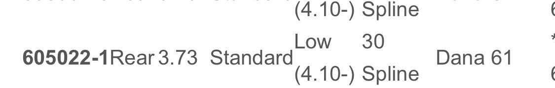

Can anyone help identify this Dana 60?
I believe the BOM is 605022-1
Update: my local differential shop informed me it’s from an 81-83 E350

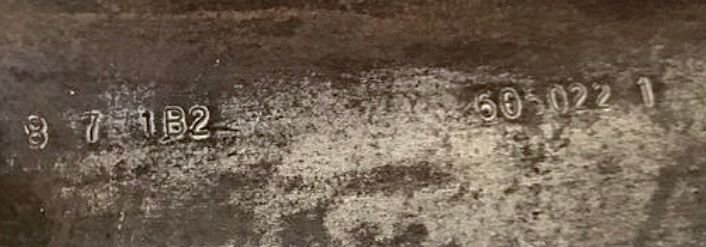

Here are the other codes

Full pic with BOM

So from the right hand numbers it appears to be a Dana 61 but I can’t find a way to determine the year

Thanks I’ve done quite a bit of searching. So far the numbers don’t show in the online docs other than the one I found above. I’m wondering if it’s not a ford. The guy selling it believes it’s from an early 70’s f350 some say the f350 didn’t come with a 61 Dana
