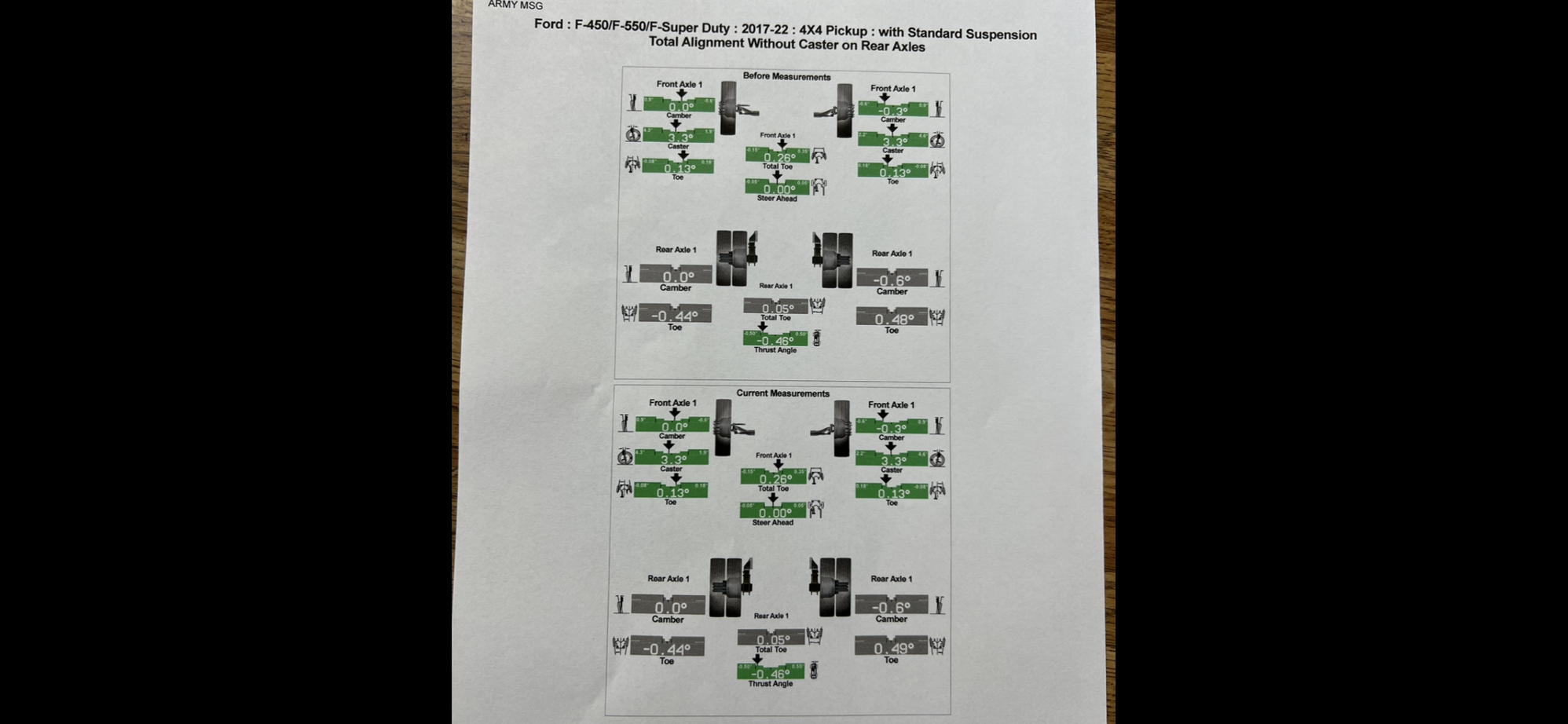

So steer tires is the next step
i had my alignment checked at a commercial truck center and they said all measurements are fine with nothing to adjust,

Can't get much better than that with stock shims. Even the Camber is spot on, that -0.3 on the right is to help with road crown. Sounds like you suffer from the dreaded round steer tire issue.

Yes.In glad I had the alignment checked out
Next steps will be good steer tires…instead of the mixed use tires I have in the front
its funny I was going to get steer for the front and mixed use for the back and I don’t know why I changed directions.
