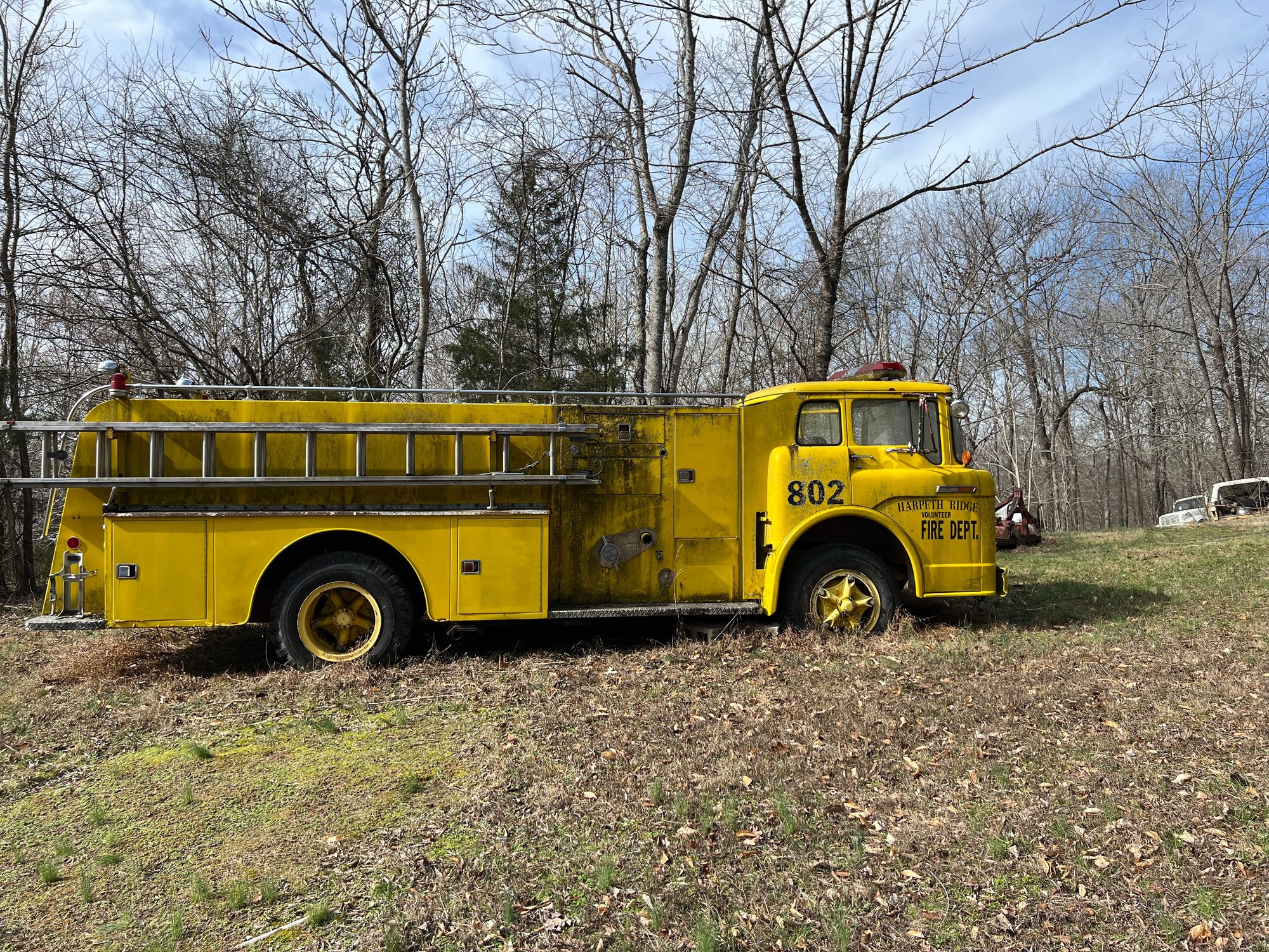

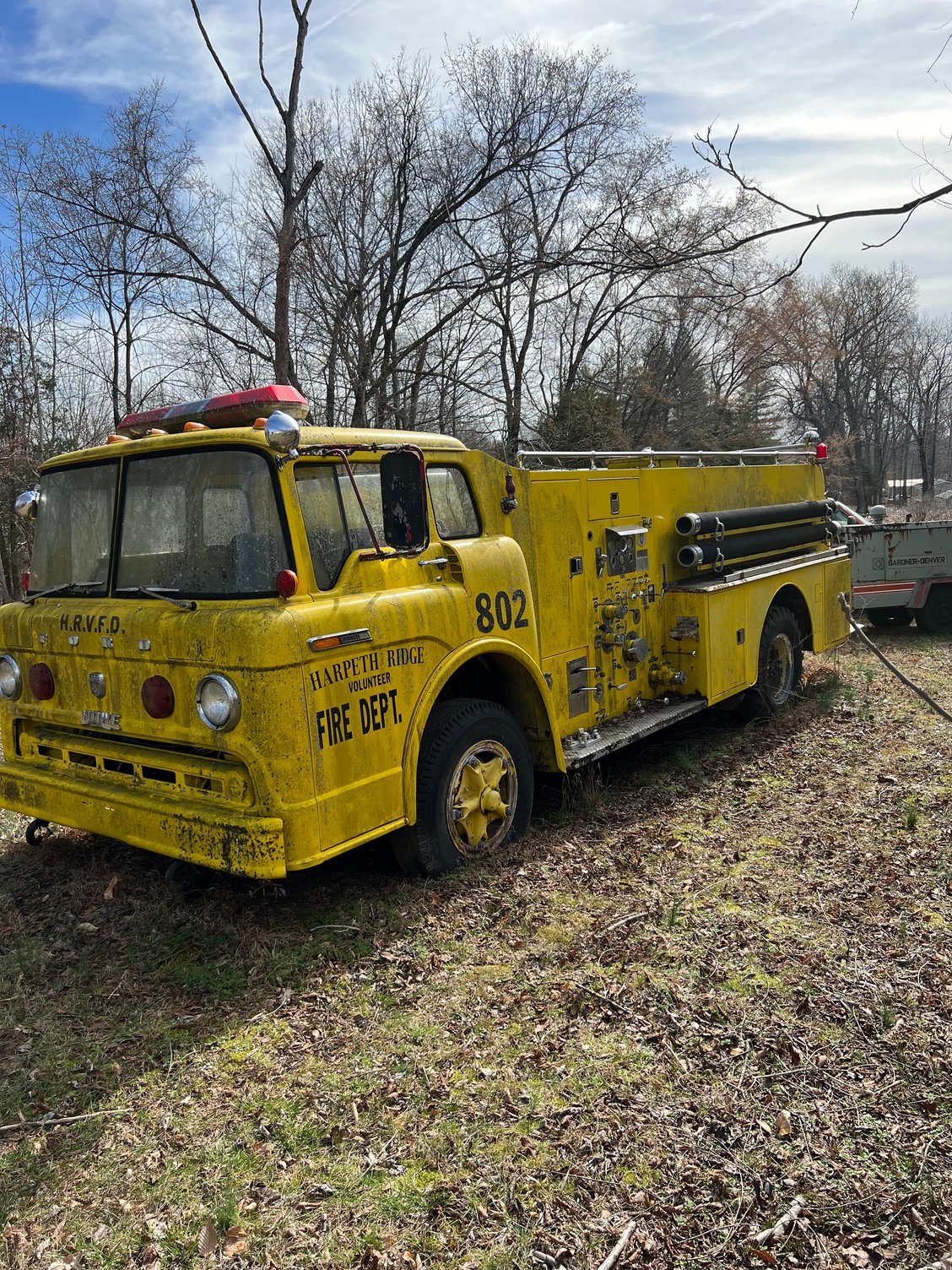

I have a 72’ ford c900 fire engine, I want newer style rims so my question is:
Is there a kit to upgrade my Dayton style (widow maker) rims to modern rims.

The rim part is available in 22.5" tubeless.
If you mean to convert to Budd style wheels, then you'd need hubs or axles.
Do you have air brakes?
Daytons did have widowmakers, the Goodyear K-28 as pictured here:
https://www.ford-trucks.com/forums/1...l#post20999916
But you can still put the tubeless rims on them.
If your Daytons are something else like a split locking ring, those are not widowmakers and are serviceable. They must be handled correctly, but are far safer than the Firestone RH 5 degree wheel.
