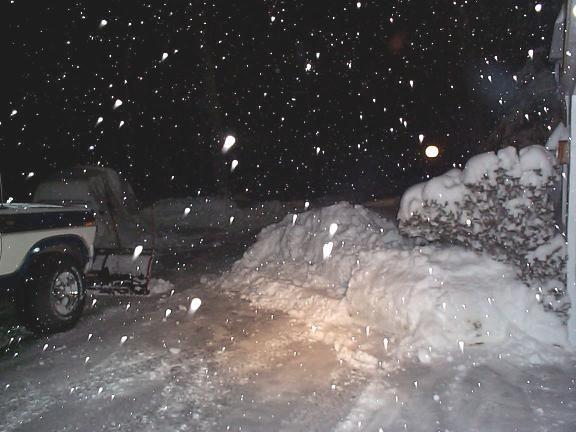

Have been doing my own "neighborhood" for 15 years in my dentside. Don't think I could do it in anything longer than the FSB I have.
For purely once in a while residential, I'd go buy a cheap FSB with a plow already.
Maneuverability in tight residential driveways is unmatched by anything stout enough to handle a plow, but still be
this short (even new 4 Dr Bronco cannot use ANY plow). Especially if you take first swipe "in", like I do many times,
and you have to turn around near house garage and/or people parked up near house.
I've done a little over a foot in one pass, with a front lunchbox locker. Maybe broke one hub in 15 years.
I did add 2" front springs, a 3G alt, and a second battery.
