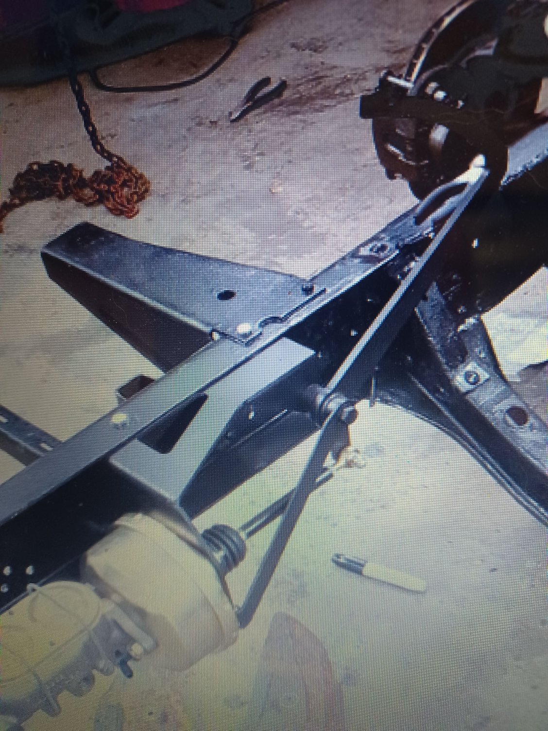

Hey guys, my life long project is still going strong. The frame I have doesn’t haven’t any brake pedal brackets or mounting, so I ordered a new power pedal bracket from speedway. For the life of me I can’t figure out where this should be bolted to and it came with no instructions. Is there a piece missing on the frame or a bracket this bracket mounts to? Any info and/or pics would be super helpful!

Ok so I’m missing the entire piece that goes into the frame section then and I suppose I need that for the aftermarket power pedal bracket to mount to the frame right? Where would I find one of those?

Old Feb 3, 2024 | 06:33 AM
330pbr's Avatar
330pbr
Joined: Nov 2023
Posts: 37
i found this pic on here......idk if this is what your looking for or if its correct

So there’s the metal bracket that goes in the frame I’m missing, the parts in the last picture are attached to it

Is this the bracket kit you got? It looks like the one in the pic from 330pbr in post #8. That should help with your location, assuming it's correct.
https://www.speedwaymotors.com/1953-...edal,8902.html
This is the same pedal set with the booster and master cylinder together.
https://www.speedwaymotors.com/1953-...al,474610.html
