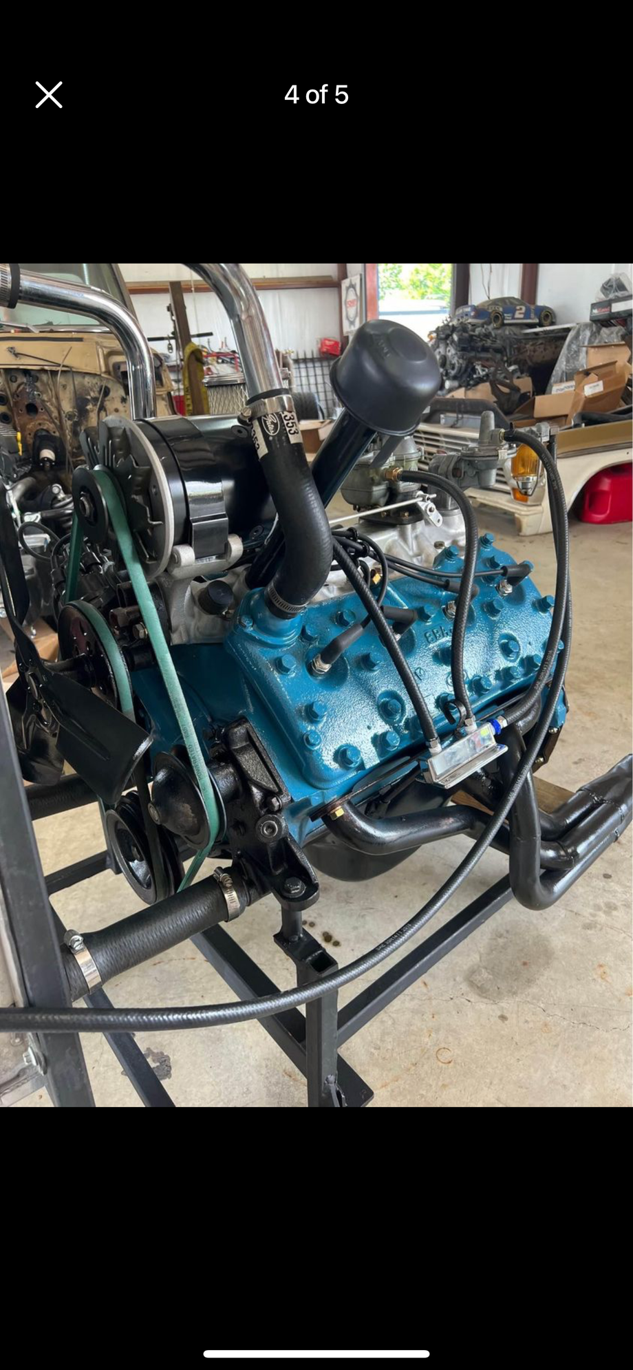

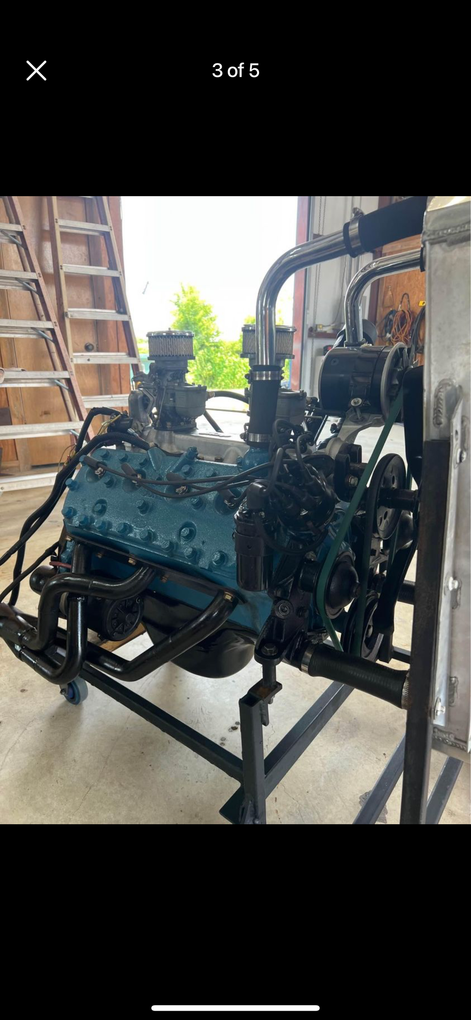

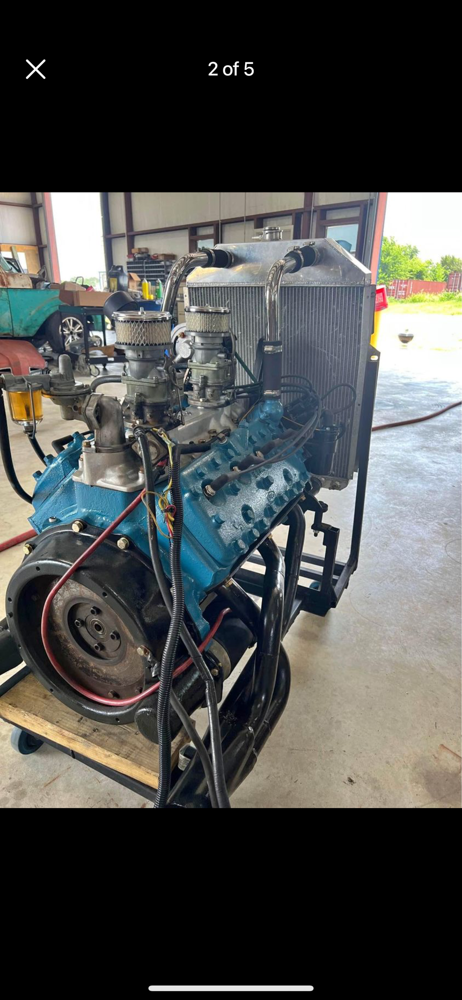

Here are some pics of what that flat 8 looks like, I’m going to put this on my 49 f1. Let me know what you all see or think
