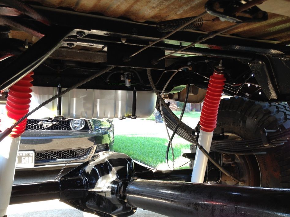

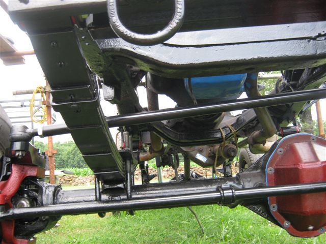

Either a 4" or a 6", IMO 6" to be safe. The biggest deal is the High Boy rear leaf springs are 2 1/4" wide, so shop carefully. Front are 3" wide and same same for 73-79.
Rocky Mountain Suspension has options. I went with Skyjacker 6" all four new leaf springs. But you have to reuse the rear OEM block.
https://www.rockymountainsusp.com/li...0/1966-79.html
Atlas Suspension has a High Boy wide rear leaf lift option. And a option to delete the rear block, and that helps axle wrap causes by big wide tires.
https://www.atlassuspension.com/1973...e-Rear-Springs
https://www.atlassuspension.com/inde...4&syear=118329
Skyjacker has longer steel braided brake lines, and remember to add angle iron drop plate on your E brake cables. Use a hose clamp to compress the little fingers that lock the cable guide in the cross member to help get them out. BOTH ideas are from FTE members.
