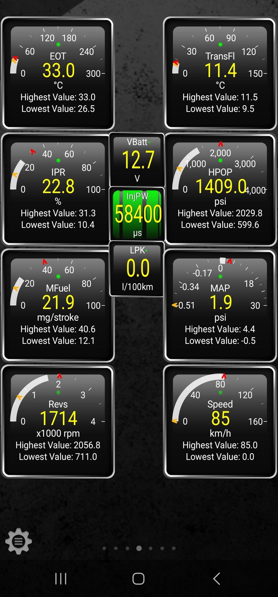

While driving while warming up, it hovers around 12.5v
once warm its around 13ish volts booting down a highway.
-sitting in the drive way after a short drive today(after the pics), with the batteries connected, but key off is 12.2v
Whats throwing me off is im not seeing 14 volt anymore. I used to, but not now. Im also noticing that full batteries should show around 12.5 volts with the cables connected im thinking if they were full.
Dash idiot gauge is nice and high. No battery light at all. Truck is starting decently now too after the battery cable work.
Engine warming up while driving.

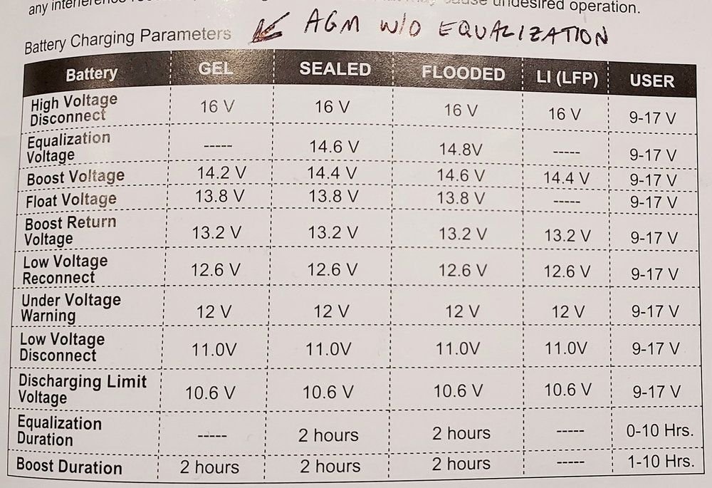

12.5 is not even close to getting the batteries charged, not matter how good they might be.
the alternator must be able to push them to 14.4 or higher to fully equalize the cells.
I bought a big 320A alternator, because I have big winch on the front, and tow a bit, it is over-kill but it keeps things rock solid all the time.
it is a Mechman 320A, cost around $500ish
this chart shows you the voltages needed to charge batteries.

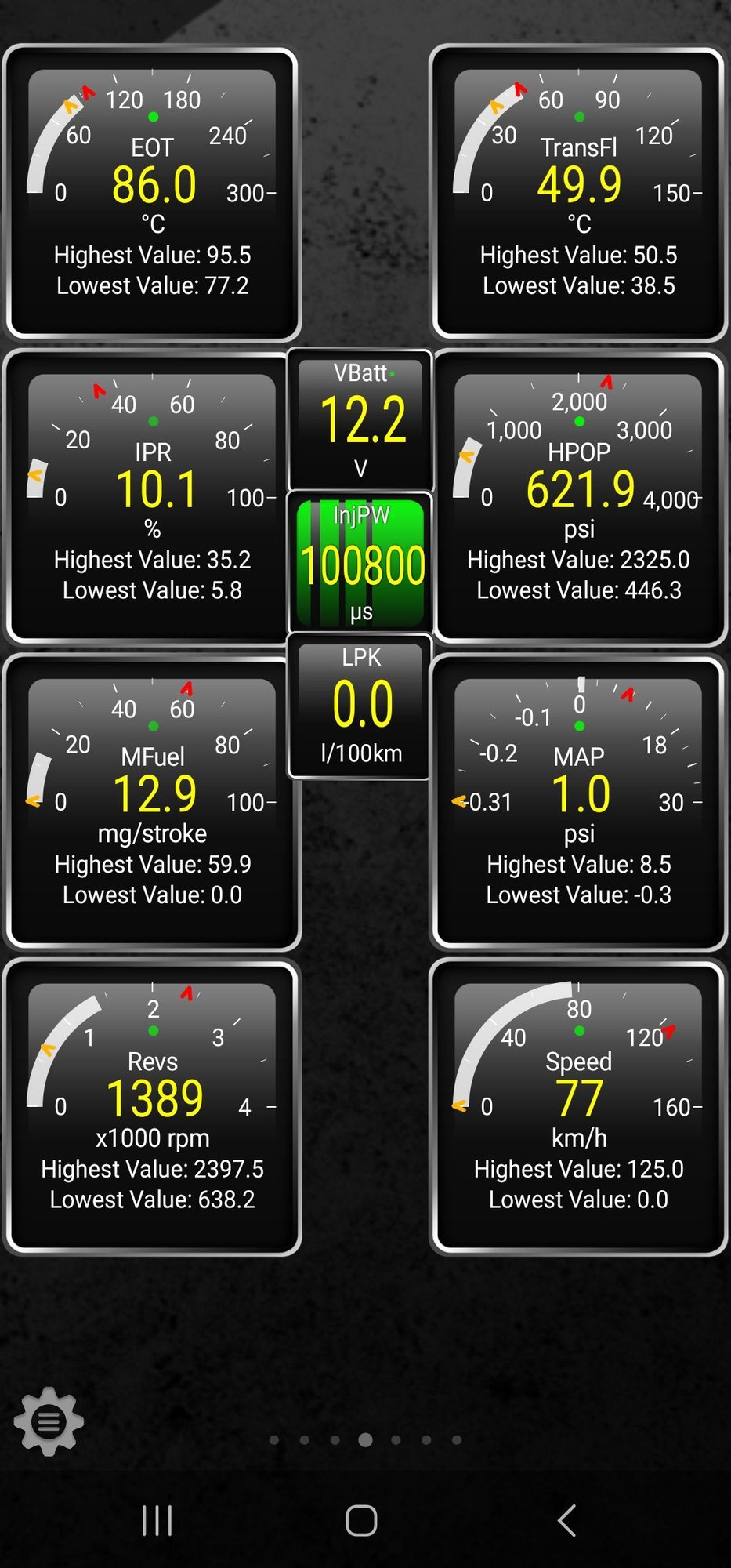

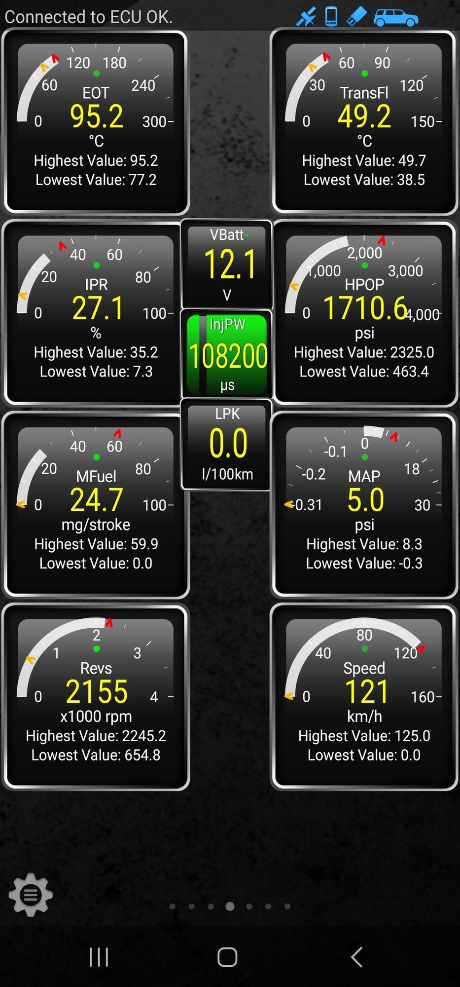

Alternator voltage at ther terminal is basicly the same as system voltag, a hundredth or so off. Tough to measure accurately as the voltage slowly rised. Around 12.5 or so driving. Idle is 11.8 now. There is a slow and steady decrease with idle voltage. I had to run into town with it after work so it got a decent drive today, about 20mi or so no reason i should be seeing a low voltage...
I replaced the alternator lug, lowered resistance a bit with the batteries fully disconnected.
Got the trickle xharge on it now to bring it back up.
Seems like all roads piont to the alt.
Going down the highway
Start up after the alternator lug change. Alternator voltage basic the same. The truck is in high idle
