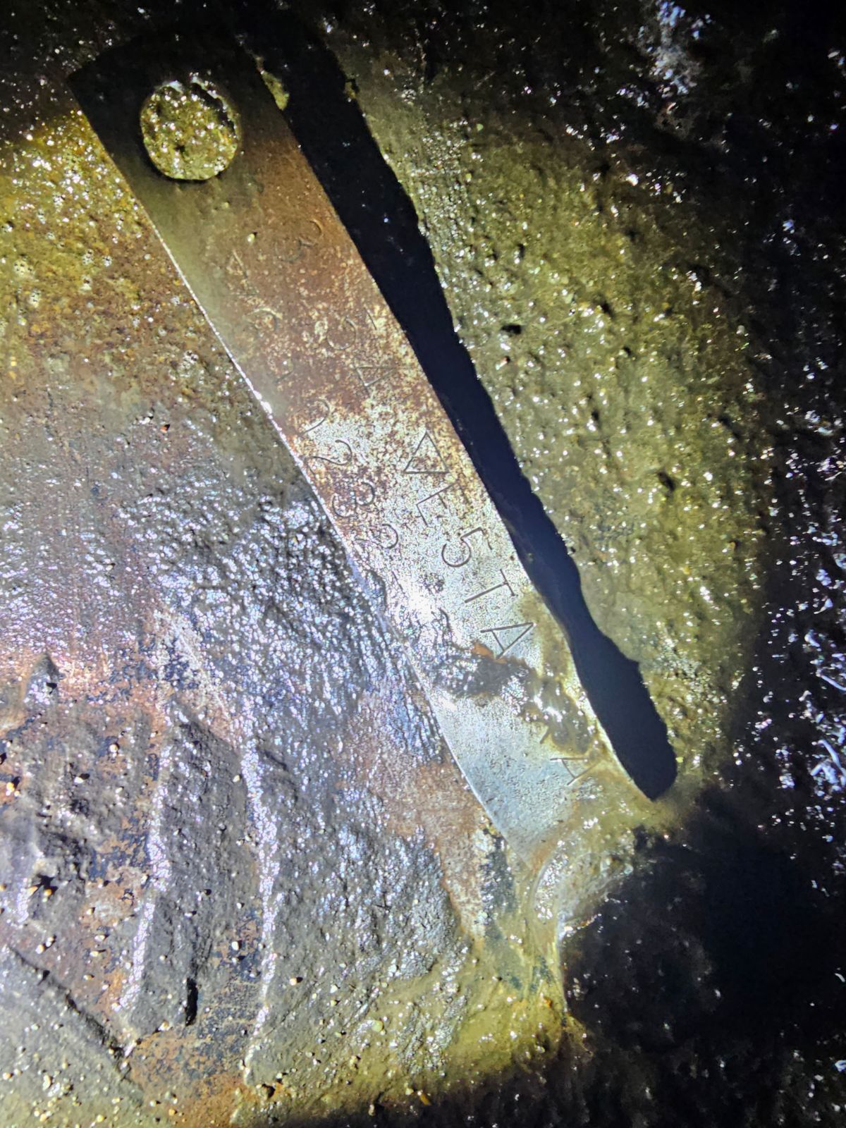

Front Axle Identification
Can anyone help me identify what axle this is? I know how to read the gear ratio thats about it. Lol. The rear was a 10.25 sterling
1985 6.9 IDI

Oh Dave .......... He is asking about a front axle ID
It is in a 1985 6.9 IDI (250 or 350?) with a 10.25 sterling rear axle as help to ID the front axle.
It may help to have a clean metal tag as I cant read any of it.

I see that now. He has only two choices for the front axle, either a dana 50 or a dana 44hd. He can look at the front GVWR on the door sticker. If it's above 4000lbs it's a dana 50. He can also measure the lockout hub diameter. If it's the same as a dana 60, it's a dana 50. If it's a extended cab truck, it's a dana 50. Otherwise it's going to be a dana 44hd
