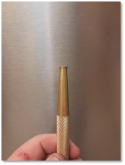

But BOY did I have to whack on some of those valves to free 'em up! I was able to get all but the final ones—#5 & #7 exhaust—with a rubber mallet, but I had to break out the brass drift for those two. #7 was the worst. After a hefty give-it-all-ya-got with the side of my 28oz framing hammer, it finally broke free. Have a look—this punch was brand-new this morning:
