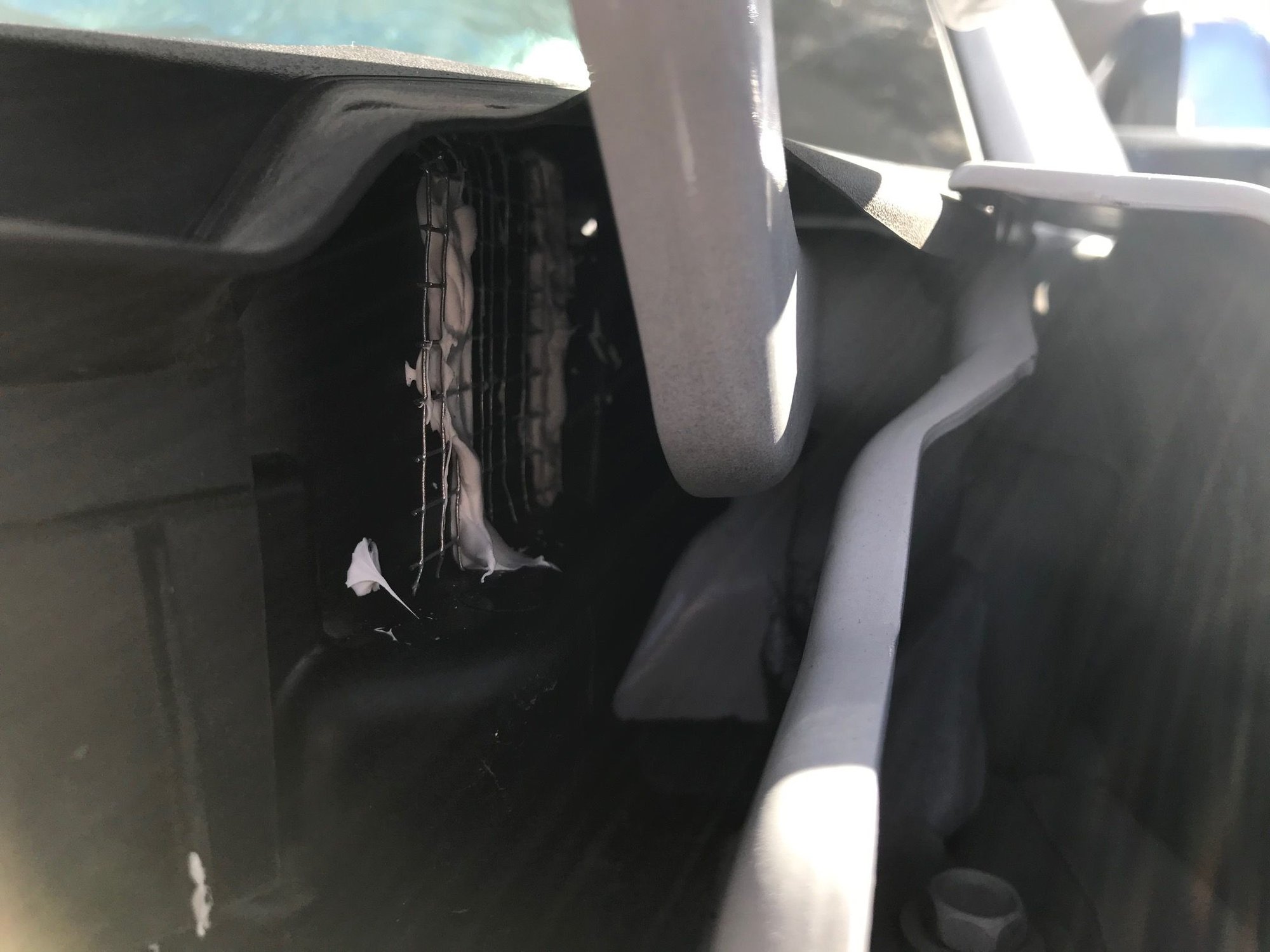

If you look under the hood and kinda next to the hinge on the driver side you may see an opening that provides easy entry for a mouse to get into the fresh air cowell area leading to the cabin filter. I have found this opening is present on some but not all trucks, and it is 100% the most likely entry point leading to the cabin filter. A very simple fix is to block the opening with 1/4” wire mesh embedded in a mastic caulk.
Here’s a foto of the wire mesh installed to block the opening:
Very cool.
That is the entry point I was looking for.
