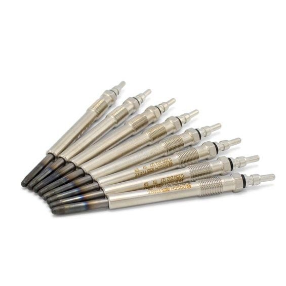

The one with a bad rep is Autolite. The tips can swell and then break off inside the cylinder when the GP is yanked. I will put a pic of those steely demons below.
I'll link a GP Pull How To pdf below. If you do pull your GPs, do not force them out like Hans Hamhands hopped up on jalapenos. They might have swollen tips.
I recall there is a thread that had great pics on how to identify real BERU GPs without pulling them, but I cannot find it atm. Details above the threads are different from the Autolites. Crimps or something.

Don't be afraid to install Bosch brand as well. They have the same excellent design and bullet tip heating element as the Beru.
