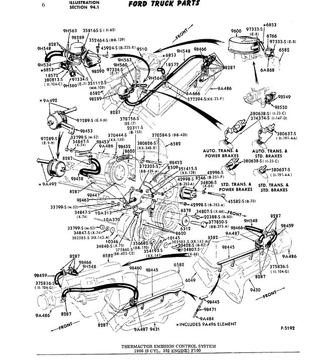

1966 F100's sold new in California were equipped with Ford's Thermactor air-injection "smog" system.

That is not how the original motor is equipped, it must be a later motor. My 66 w/352 was built in San Jose. Never seen it on any other 66, California models or otherwise.
Hey, That is my truck!
I thought those were in cars in 1965, and trucks later? If those were on trucks, then every 66 I’ve ever seen had owners that removed them.
Note: I stand corrected, I believe they were on F100’s, not on F250’s? Please straighten me out?

The engine in that photo has the correct 66 tag and there is a NOx Califonia emissions decal on the truck's window. The truck also has the correct door tag. I think everyone else has removed them. I have a 1966 Mustang that had it removed but they rebuilt the engine on my Mustang before I purchased it, so it would make sense that they removed the smog system.

The CA F100 had Thermactor, the F250 had a closed pcv system. There might have been exceptions.
My '66 was built with the Thermactor system. I regret removing it, but I got a nice price from a guy restoring a Ranger that had lost its smog stuff.

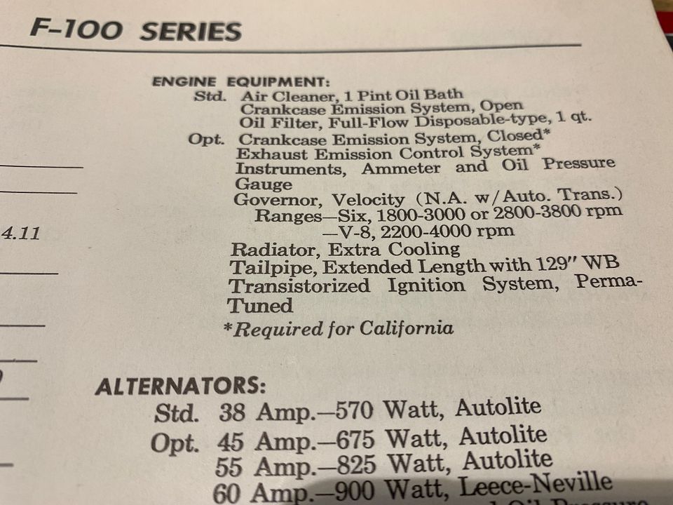

The Thermactor system was only required on 1966 F100 and F100 4x4 destined for sale in California, optional everywhere else. Also used on the Econoline E100. The Salesmans Facts Book calls it the Exhaust Emission Control System or EECS
The Boss has that system on Rainbow Ranger that he is restoring.
Restoration of my 1966 F100 Ranger - Ford Truck Enthusiasts Forums (ford-trucks.com)
Also used on 240/300 6 cylinder engines which uses a different drawing than above.
Eric
The F100 could have both systems. The F250 just the crankcase system not the exhaust system. One of the reasons I sway toward F250s.
