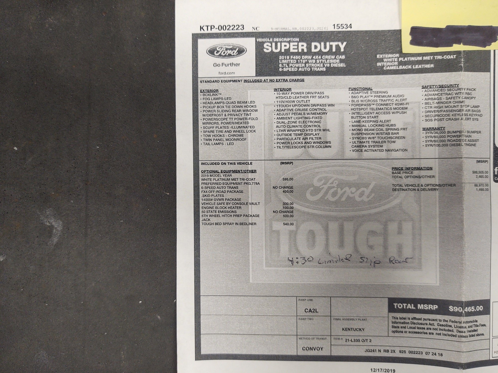

Hello everyone, I am new to this forum and was looking for answers to something that I am confused about.
I own a 2019 F-450 Limited. I bought it used with only 3000 miles on it. The previous owner obviously never drove it.
It has about 75K miles on it now and during my latest maintenance I decided to replace the fan belt. Now this is my fault, but instead of actually going and looking at the truck first hand I did research online to find out if it should have a single alternator or a dual setup. EVERYTHING I saw said that all Limiteds came standard with the dual 332 amp alternator setup. So I went and got the belt. After that I decided to look at the truck and found out that it has only one 220 amp alternator.
Can any one explain why my truck only has one alternator and not two when all of Fords model spec sheets for super duties say duals for a Limiteds. They state that for model years 2018, 2019, and I think 2020. I am not sure about the newer model years.
Any insight that anyone can give would be appreciated. Thanks

I do have a copy of the window sticker and I did look at it. It does not mention anything about alternators but I figured that that was because they were supposed to be standard. There certainly is nothing mentioned about an alternator delete.

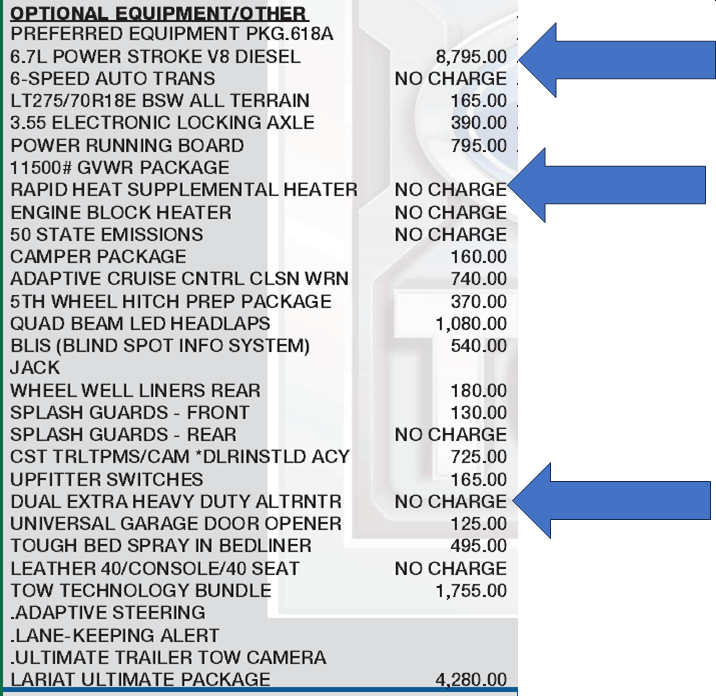

Doesn't look like it came from the factory with the dual alternators. Here's the section of my window sticker where the dual alternators are explicitly called out (last arrow).
