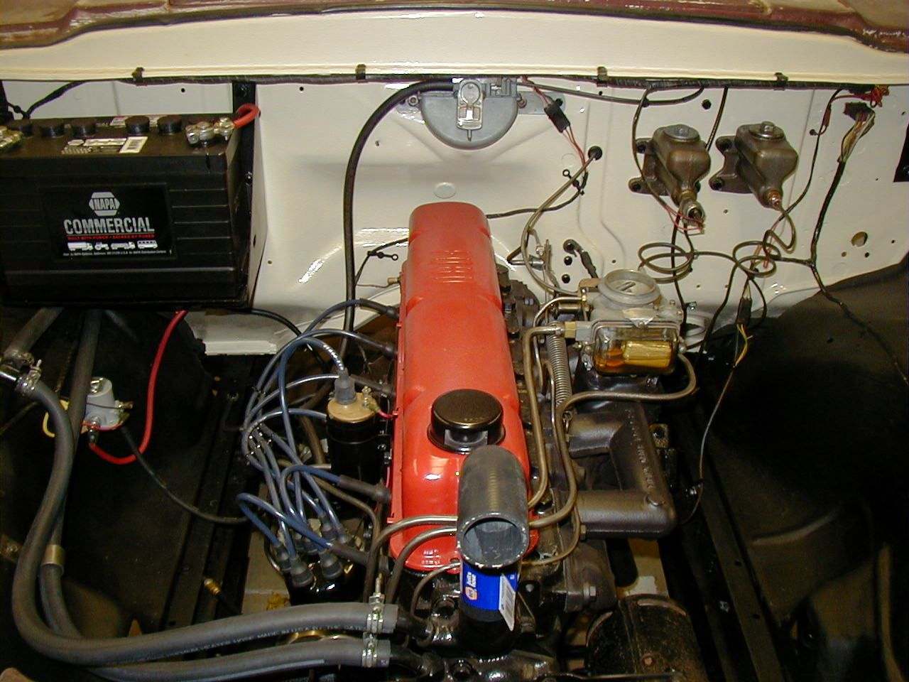

So I have the heater core repaired and have a water valve for the magic air. Can anyone tell me where and how I route the hoses I have one that comes from the water pump to the heater core and one that come from the engine block on the passenger side. Where does the water valve fit into this equation. Thanks!!

Here's
a pic of how it works on my 223!

I have a 1960 F100 with a 223 with a different location for the on/off valve for the heater.
Doug
The valve is connected to the thermostat housing.
Doug
I have seen those manual style valves. They get the job done. I don't really drive to much after it gets cold as they start with the salt business.
