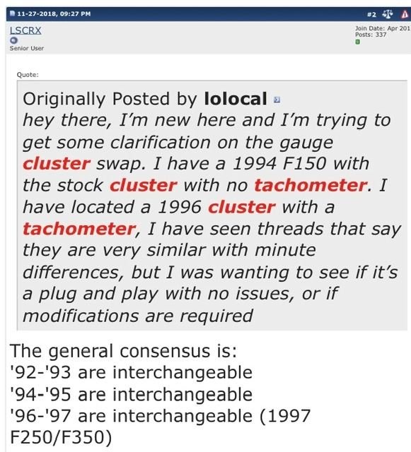

Is this what you were talking about?

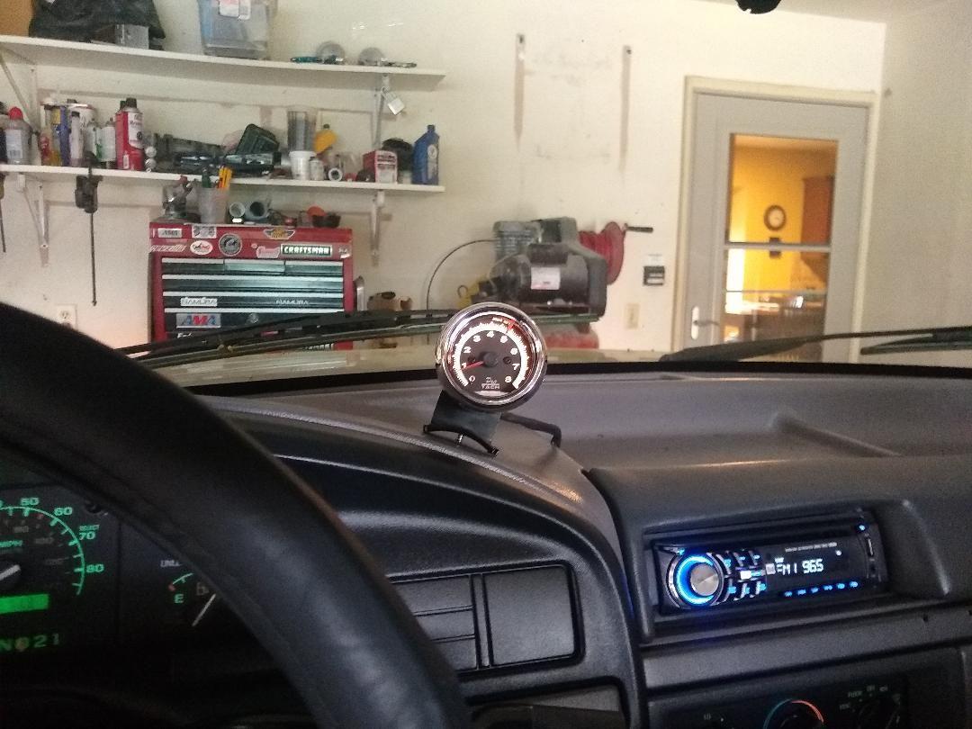

Tach installed and reading perfectly. THANKS FOR THE HELP GUYS!
