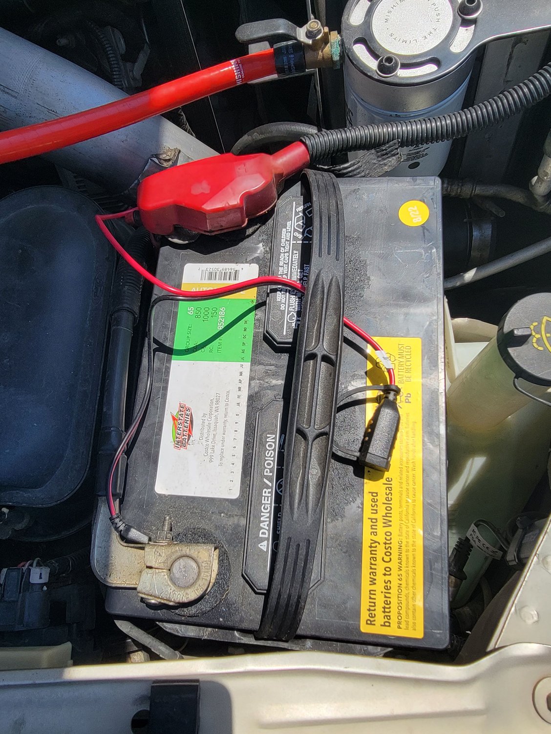

Pic of battery's. 850CCA

>>Pictures of the top of your batteries, please. We need to see the cables and attachments. Show where you are hooking up the voltmeter, too.
A picture of one battery and the terminal covered accomplishes nothing.
I am about done trying to help in threads where it takes post after post to try to get answers when trying to help people. I just went through his crap in two threads over at the org.......

Just to be thorough (and the 6.0L certainly does challenge us in that department), what does the positive terminal look like under that cover? Also, what do the terminals look like under the other battery? (post #2 and #12)
Lastly, you were asked to show where you hooked up your terminals?
Just might help reduce future frustration.
