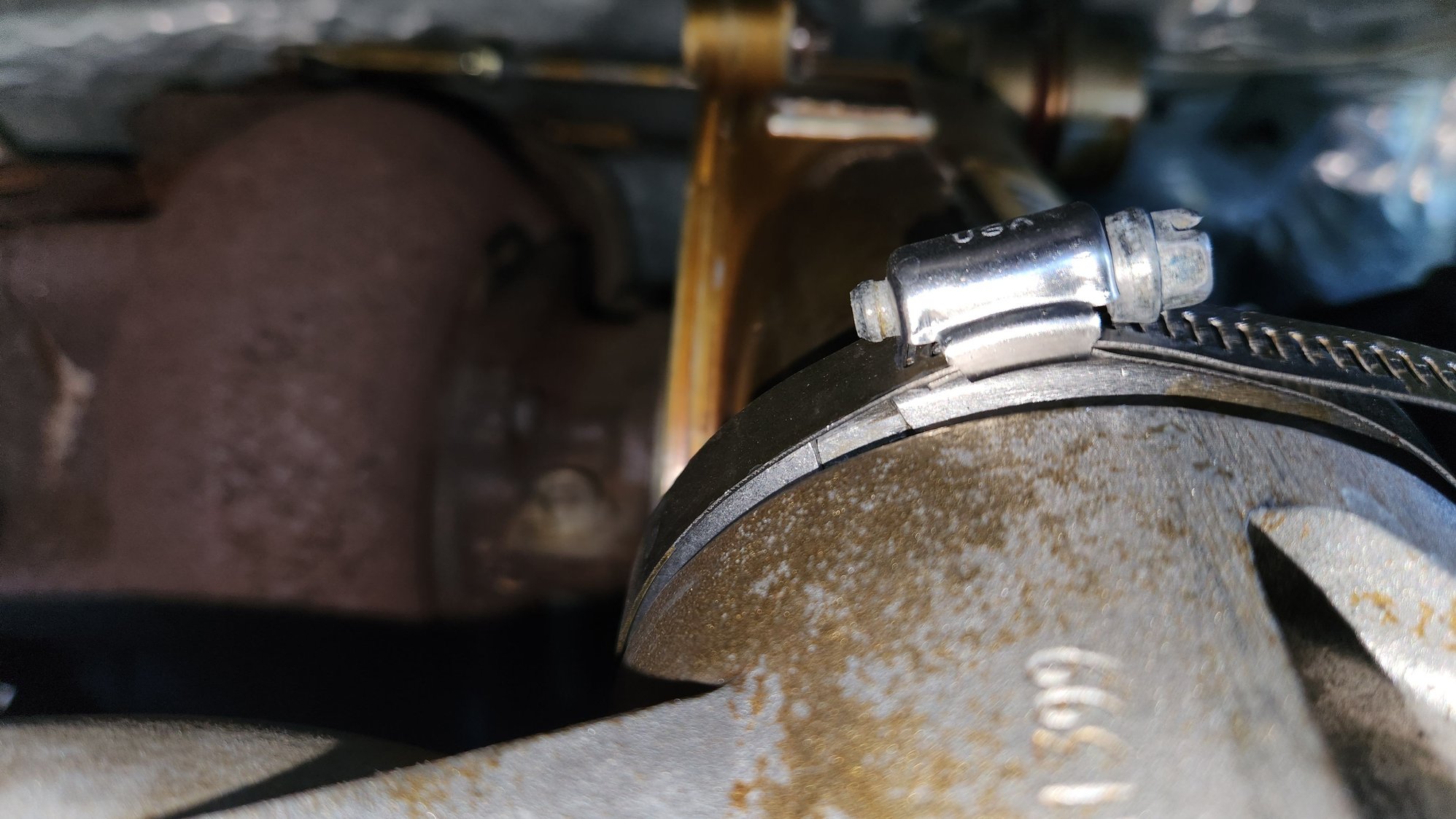

A few days ago I noticed my truck was making a strange ticking noise. It wasn't constant but when I would tap the gas I would hear a popping tapping sound kind of like creaking suspension. Put the truck in park taped the gas and nothing back in drive tap the gas almost like a bad mount. The next day they sound got more frequent. I could hear it everytime I took off from a red light or traveled slowly. When I got home I proceeded to give the truck a thorough inspection. Check all of my fluids oil trans and diff all looked good. Next check my u joint and carrier bearing all in decent shape. I had a rebuild kit for my fuel bowl and figured why not. Popped off my valve covers everything looked nice and tight and in working order. Removed the dust cover on my trans inspected flywheel. Mostly good except for the plastic bag the nice fellows at the transmission shop left in there for me to find. Pulled my air intake tube to check the turbo noticed a little more left to right play that I would like but no in and out. Fins have looked better but I think that's how they looked when I bought the truck.
Then as I'm putting everything back together I finally see it.
Looks like my turbo has developed an exhaust leak. I guess my questions are what are my options. I'm leaning towards overkill and thinking kc stage 2. I plan on upgrading my injectors at some point later this year. I dont haul much at all with the truck. Most of my miles are highway with some around town stop and go. But rather then firing the buckzooka at it because I have an excuse to is there a semi cheap option to clean this up. One that I won't regret upgrading the turbo while I have it out.

Yes looks like a cracked turbine housing.
Compressor dusted too.
What injectors are you planning?
Don't go too big with the turbo.

Well good news now that I'm not completely exhausted. No pun intended got to take a better look at it today on my lunch break no crack in the housing one of my bolts is missing. Seems to be a common problem. Anyone know where I can source 1 of these bolts if not ill be getting ahold of international in the morning I hear there set is cheaper then fords

$9 for the set at Riff Raff.
The new ones have scientifically buggered threads so they are less likely to back out.
But if the missing bolt is in a bad spot and you have to pull the turbo anyway, I'd bite the bullet and go with an upgraded turbo. Your compressor wheel is looking ragged and the gap to the housing there looks worn. And bellowed up pipes. It's something of a PITA so doing the job once makes sense to me.
