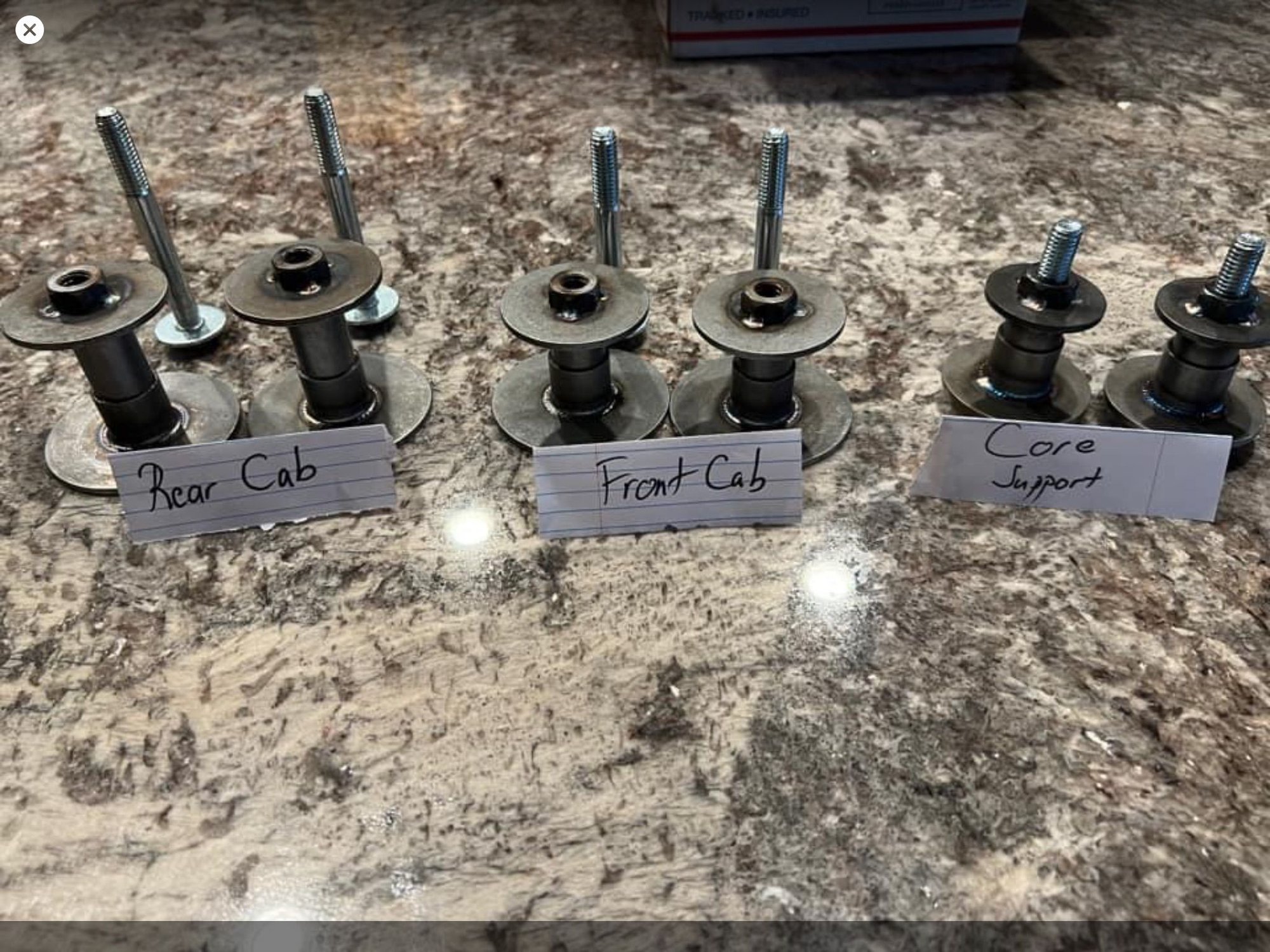

I ran across these and can’t remember where, i don’t know if i saw them on here or another site.
I’m wanting the make some and was needing some questions answered.

Those look pretty. When I did new cab and core bushings on my 72 f250 4x4, I had to make them similar to above picture. I used the poly bushings and hardware was nowhere to be found. Is your truck 2wd or 4wd? What is your questions?

Mine is 2wd and I’m wanting to make some and was needing to know what size pipe to use because the ones in the pic, the pipe looks like it fits inside really good.

I remember just going to a home depot and sizing some different size pipes roughly from 3/4" and 1/2" to make what I needed. Also some big washers. Depending on what type of bushings you use will determine what length to make your hardware. Rubber will crush more than poly.
