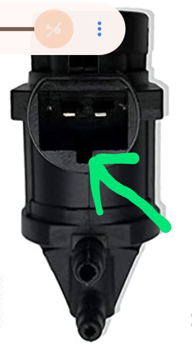

The TAB solenoid electrical connector has a keyway slot that is centered. The TAD connector's keyway slot is to one side. The picture is of a TAB solenoid connector.

Excellent video!
