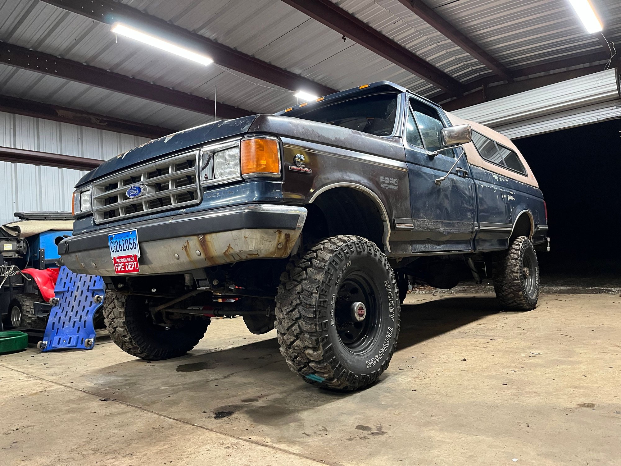

I went with Sky's kit for the 1990 king pin SAS into my 87 F350. Very pleased with the kit and the customer service. I went with SD springs as well; I got the stiffest one (X code, IIRC) because I plan to eventually add a a winch and winch bumper.
Here's the video that I shot of the install:

Being a play thing/work truck, I opted to keep the OBS spring along with Sky's RSK. It installed easily enough and drives great. I honestly didnt realize there were other options until reading this post, but id recommend Sky's product for sure. Be aware their shipping costs are a little shocking.
PMF doesn't make an RSK for the bricknose trucks. I have a Sky's kit on my '89 and have no gripes.
I dig your truck, by the way.
