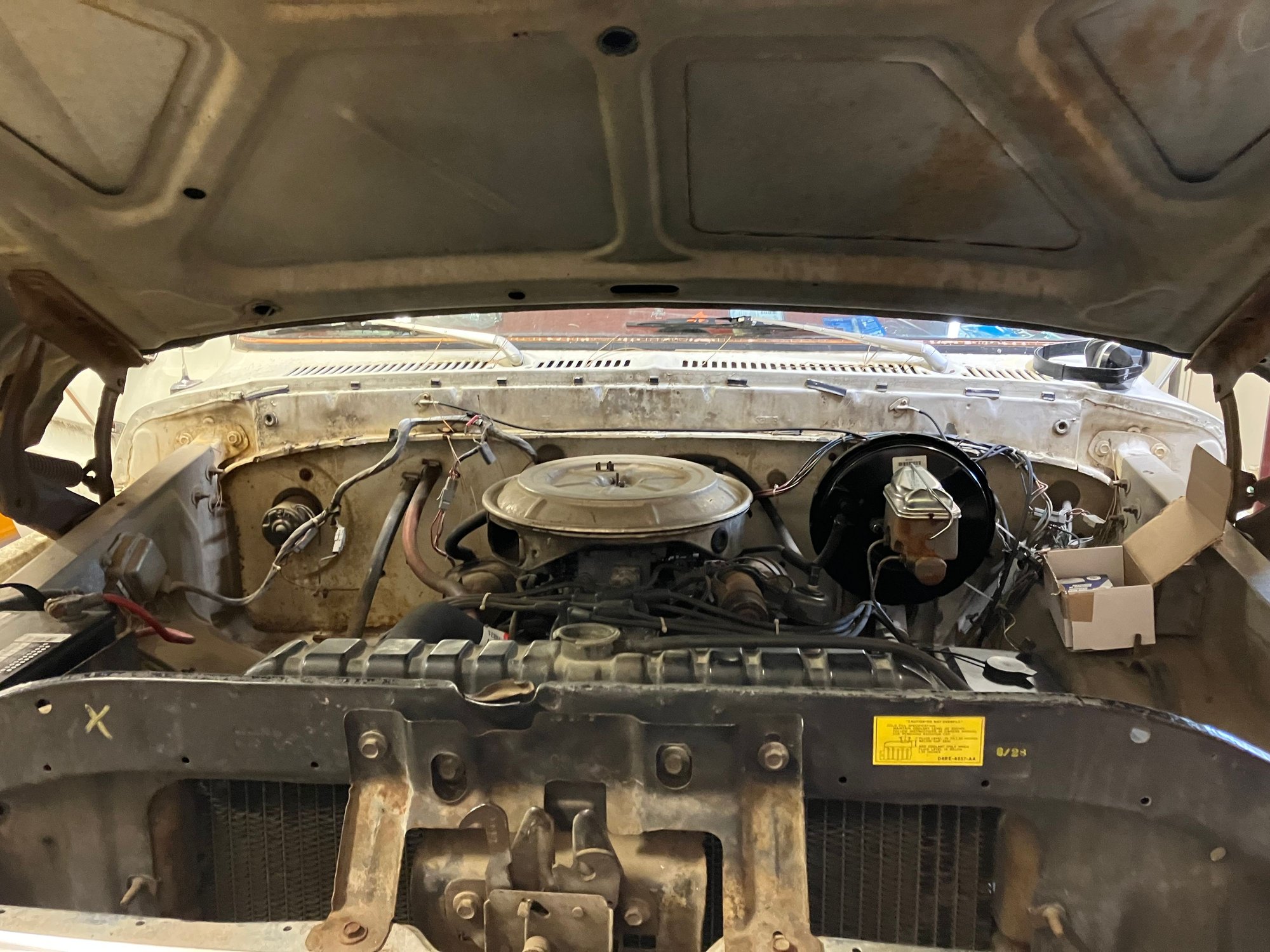

well i'm back and took it for a drive and it barley runs any thoughts.
i hooked up a vacuum gauge and tried to tune it and it did nothing and it runs better with choke on so i assume its vacuum
mainly because the tree was literally being blocked by a screw so if you guys have a vacuum diagram would really help thanks
by the way incase you guys did forget what my truck is it is a 1978 f150 with the 6.6 lt 400 4wd with a automatic transmission
The engine running better when the choke is closed, usually indicates something such as it’s running very lean (because the choke richens up the fuel/air mixture) or the spark from the ignition is very weak.
possibly indicating vacuum leaks. Which leads to the next questions.
The vacuum tree is not supposed to be open. If part of it was blocked with a screw, it was probably to close an unused port, or stop a vacuum leak.
Did you remove the screw? And if so is the port it was blocking now open?
Any chance you can post up some detailed pictures of the area around the engine? Specifically the area around the carburetor and vacuum tree?
thanks.

i got a proper cap to block it. there is noting connected to the tree besides the engine and brake booster. all blocked with caps on the tree. and with the fuel mixture even when i adjusted the mixture screws the engine did not change its sound or even run smoother it only had two phases rough running or dead

this is all i got besides this old ad for a school project when i first bought the truck and had only put in a new fuel pump and fuel sender unit and cleaned out the tank back in 2021 december i think though it runs even rougher now then the video portrayed Download 5A262B02-D85D-4528-BF23-7E0827FE4CD8.MOV
