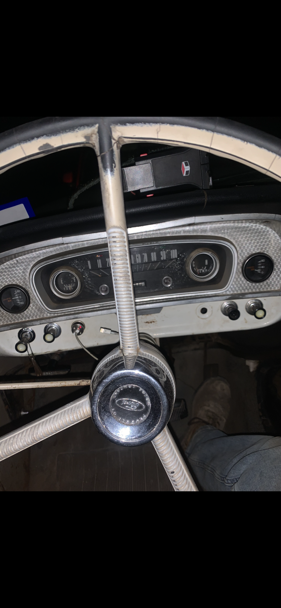

I have a 1966 f100 custom cab and my hazard switch is missing. I am wanting to find one for it but on my truck there is only 3 holes on the right side of the steering wheel instead of 4.
It has a hole with a missing item on the far left, then there’s the choke in the middle and on the far right is the heater switch/lever.
Does anyone know how it’s supposed to go?
Does this mean that I need a switch without a light to go in that hole or is the light supposed to go in the hole on the dash and the switch be located elsewhere?

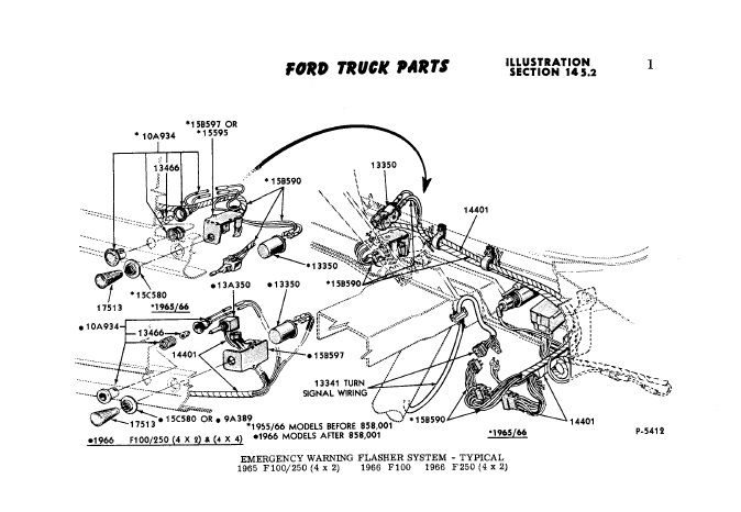

The Emergency Flasher was included at extra cost but did have a Delete Option Available. Looks like your truck had the Delete Option selected. You can drill the 4th hole yourself and do it like the factory did it or you can do it differently if you like. Second picture is from the master parts catalog for the 1965 F100/250 (4 x 2), all 1966 F100 and 1966 F250 (4 x 2).

Thanks for the info & diagram TA455HO
