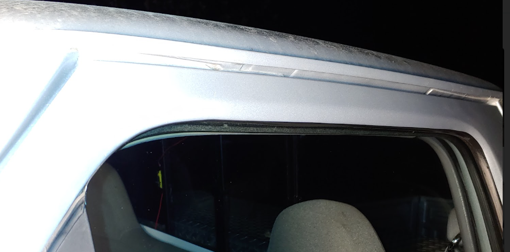

Old Feb 6, 2023 | 02:10 PM
AuroraGirl's Avatar
AuroraGirl
Joined: Jun 2021
Posts: 5,219
Likes: 804
Originally Posted by TobyB
The other thing that happens is that the upper hinge gets overextended
and pulls away from the body, and then the door frame doesn't seal well.
Right by your left ear.
t
this was after bending the door back in a few places(NOT THE hinge) and I was able to reach the strip more as well as used foam backer rod in rhe bodydoo
