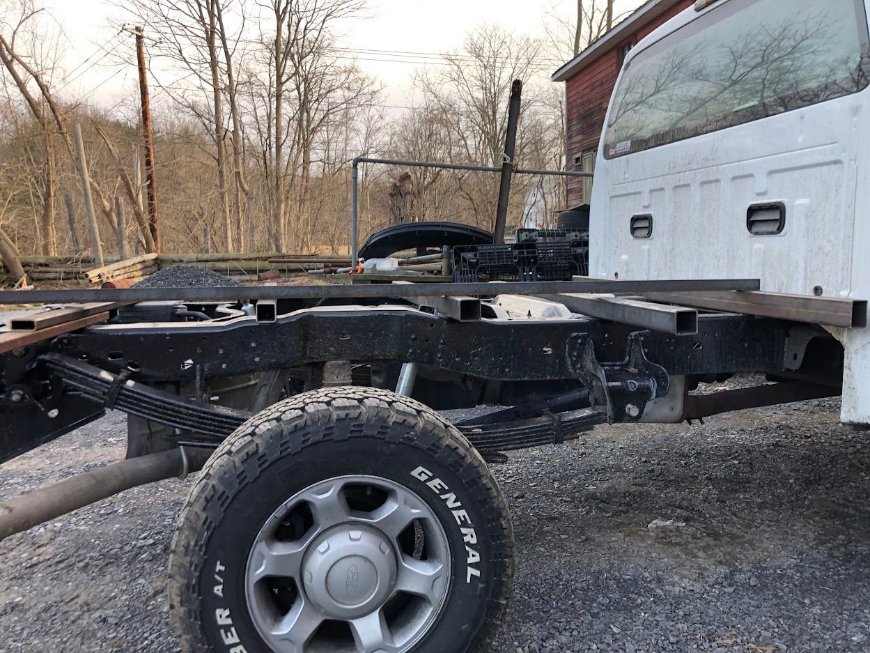

You'll want rails that go the width of the cab. I'd suggest doing 4x4's for these. step 1 though is to take a 2x4 or a 4x4 and shim it up at the arch above the axle (the highest frame point). Then using the board front to back, level and measure the distances from the board to the frame at each bed mounting hole. This will let you make spacers from the frame to the side to side rails. Maybe this gives you an idea of what I mean:
Here I was using the near correct size box steel, which I'll be darned if I can find those measurements again. Put a 1/2" hole thru your spacers and measure the frame to determine the distance between rail mounting holes so you can put those in them. Bolt your rails and spacers down using 1/2" carriage bolts so when you draw em tight the head disappears into the wood and the surface is flat. So once your rails are now "level" you can begin decking it out and make a box frame around the entire thing using the rails for screw points for the side trim boards. Add some d-rings and stake pockets, maybe make some 12 or 18" tall bed sides. Get creative. Be sure to exterior grade poly the wood, and while still wet toss dry play sand across the poly to make it slip resistant. Or spray it with Raptor. Absolutely be sure to seal the BOTTOM of the boards against the elements, your going to wing rocks, stones, but especially mud and road water up onto the wood and that is where it's going to rot, especially if you live where they salt the roads.

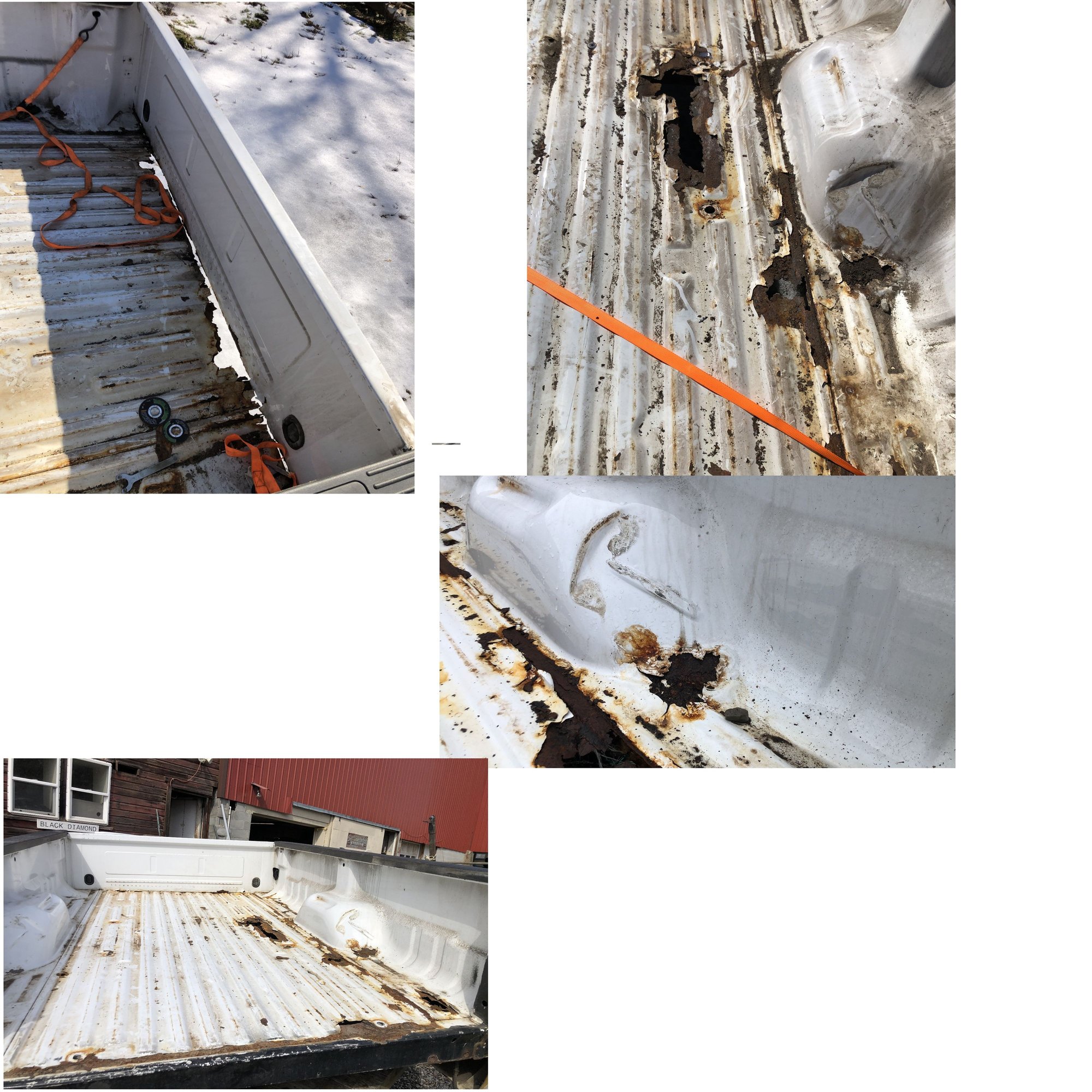

That white truck, the header panel was separated from the floor and about 1-2" was missing of the floor there, (3) 4" holes in the floor from the bedliner, and the rails were all gone along with the tail/lip section. I had over 10 people contact me on a listing at 900, it ended up selling for 1100, in that condition, with a horrible ladder rack topper with a smashed in corner that I was worried I'd have to pay to scrap. To me only the bed sides were worth anything, the tailgate that it went with had 2 tears in it and the handle hardware missing.

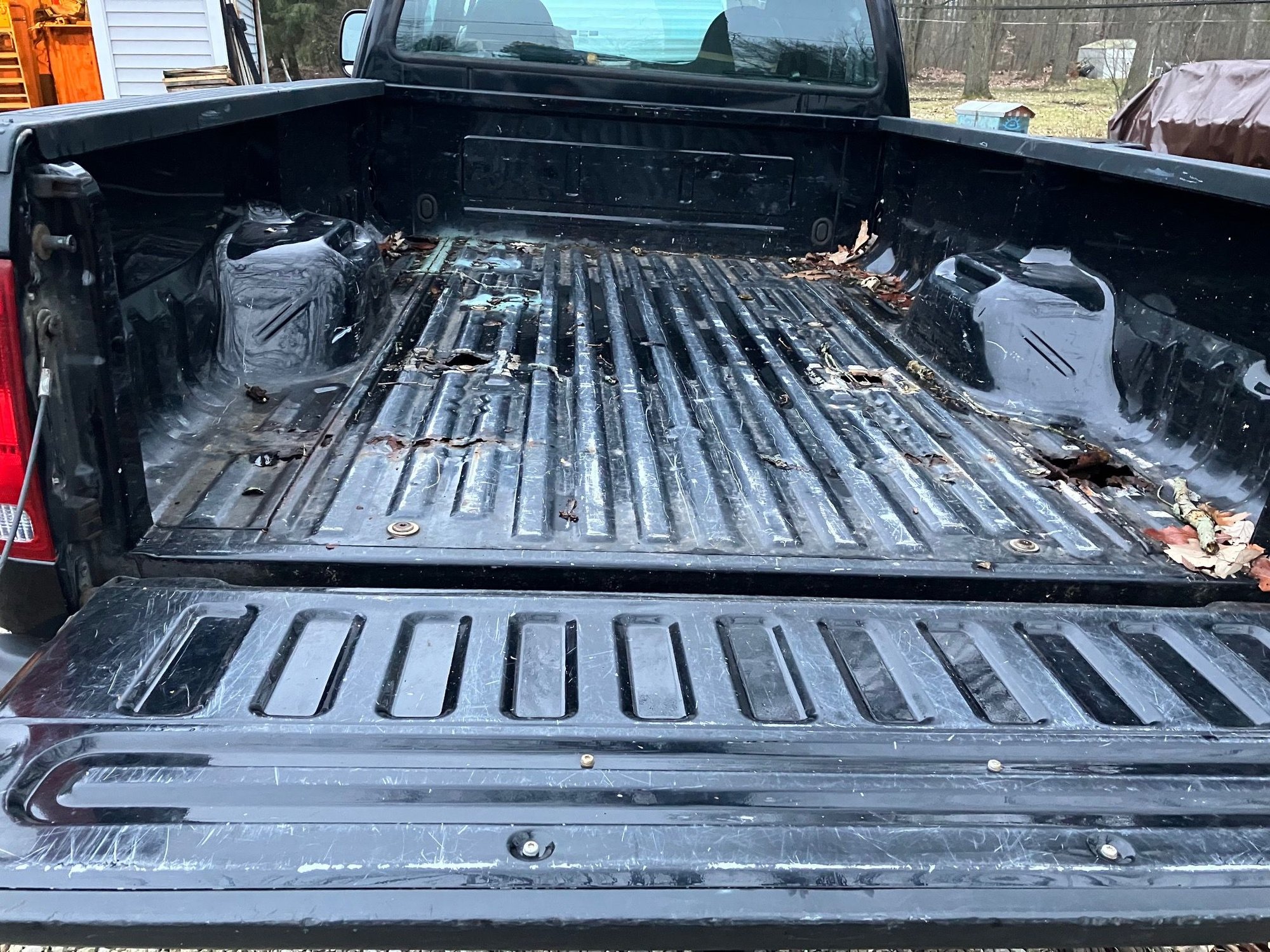

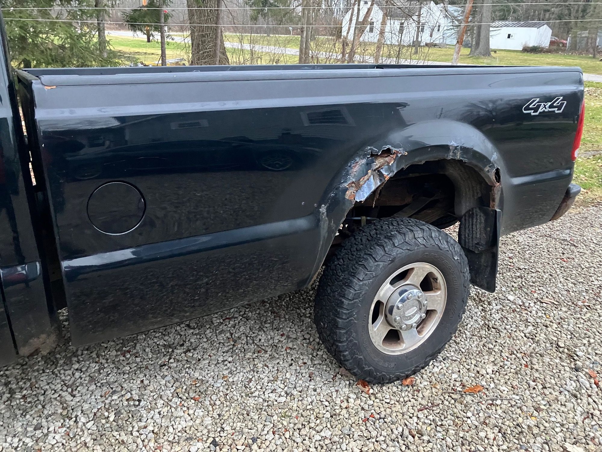

!!! Mine has some holes in the floor and one fender has rust but tailgate is perfect. Maybe I should try to sell it. Actually, if I was still working I could have fixed it at work. What is a good place to list it?

Thats actually an easy fix with about $1000 in parts. I did that on a 2012 a few months ago. THe floor wasn't as bad, and just took a patch, but all the cross members were shot and had to be replaced, and a reskin wheel arch fixed the rust hole. Then I painted it and it looked pretty good.
