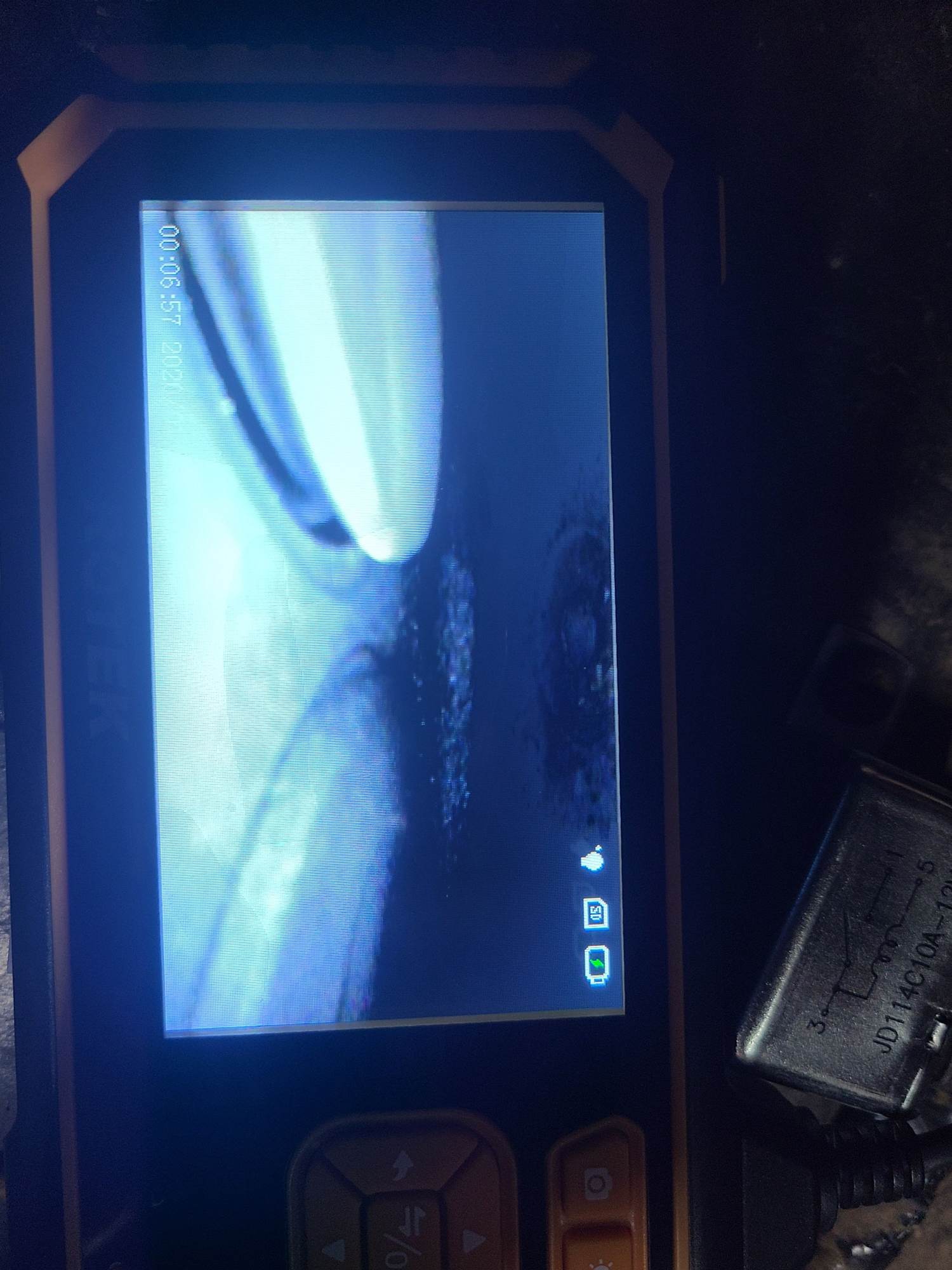

Here are my findings...
Fuel Pressure is 3psi
Compression Test (PSI)
C1-140
C2-134
C3-132
C4-143
C5-136
C6-142
Spark Plug Gap
30-35 thou all gapped to 33 (I have Pertronix flamethrower)
Spark Plugs
Spark Plugs [C1 Bottom, C6 Top]
Endoscope Images
Cylinder 4
Cylinder 4 Valves

The compression numbers look OK. You can't really tell much about a spark plug if the engine has been idling very long before it was shut down. I see you have platinum plugs. These old engines really prefer regular old copper core plugs. The platinum plugs are really for these new engines that run a lot higher combustion temps than any of our old junk. The only thing that stands out on the plugs is #4 and #5 are showing a little too much spark advance. The color change should be right in the center of the curve in the ground strap.
