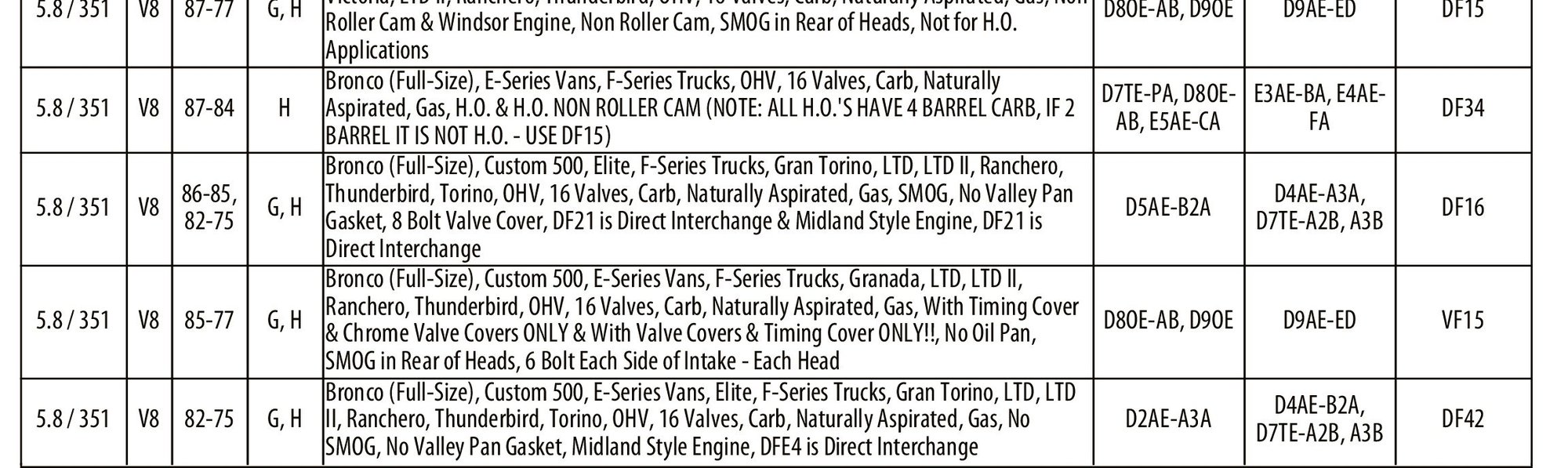

I was originally looking for a hydraulic roller cam however after seeing the waiting times I gave up, I called several machine shops, none of them in my area rebuilt engines anymore. Finally gave up and actually placed a order twice for a flat tappet cam reman for 93, one at advanced and the other at autozone. Both got declined 2 days later by manufacturer due to them not knowing when they will be getting them back in. Went to autozone in person and found that engine model VF15 was in stock. Originally was going for a DFA1 but was unavailable once they called atk. So I went with VF15 at autozone.

A quick search on atks site shows it will be a d80e block with d8 or d9 heads.
So low compression, probably iffy quench rebuilder pistons. It will work, just dont expect to set the pavement on fire with acceleration. Cam will probably be okay with the efi but who knows what they are actually using for a cam.

That chart says it comes a timing cover. It will not work on your ‘93 because it will be for a standard rotation water pump and have the hole for the fuel pump so it will have to changed.
