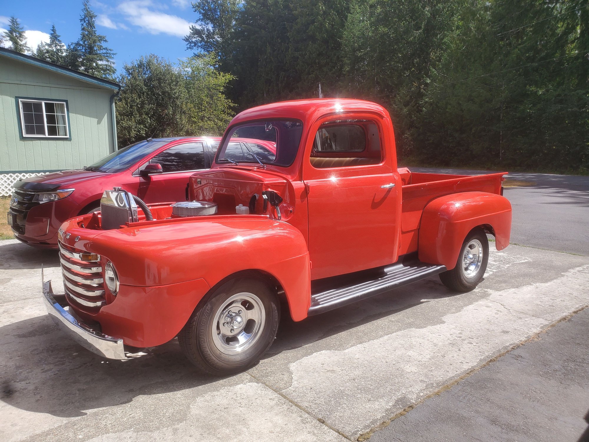

Still a few things left to do but I have it on the road.

Very nice!

Enjoy the ride.

Looks great

Congratulations....enjoy it.

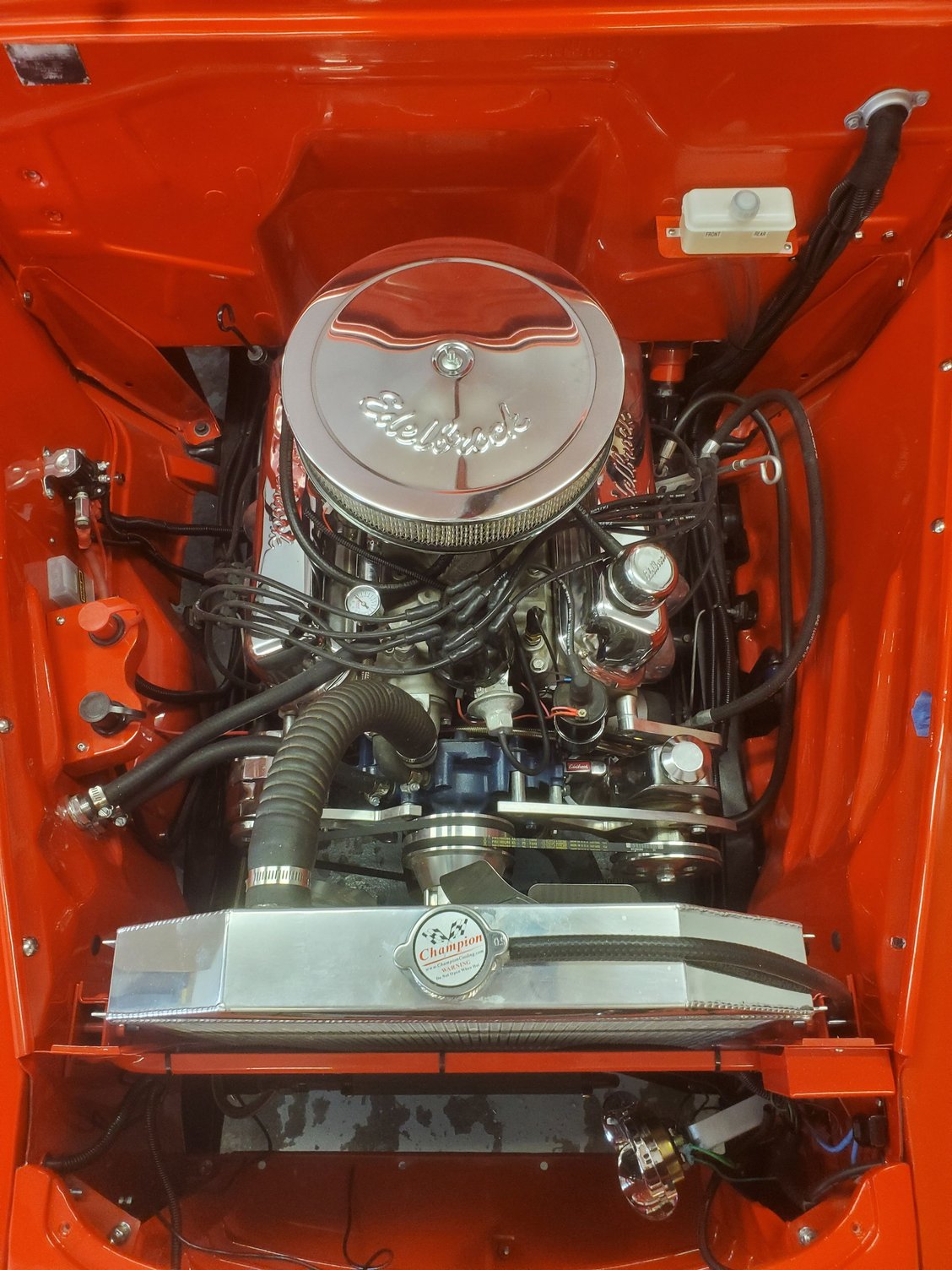

I like your clean firewall with no visible wiring. Very nice. Did you route the wiring down low?

I put diamond plate on my firewall and all the wiring i tried to hide down low. And I forgot to tell you mine took about 20 years so you are doing great and the truck looks great too

Wires go down to chassis then forward to lights. Ignition, water temp, oil and choke wires exit into another loom by fuel pump and up to each item. Starter wire goes down under cab then forward to solonoid. Heater hoses go out through the side of cowl then forward under fender and enter through inner fenders
